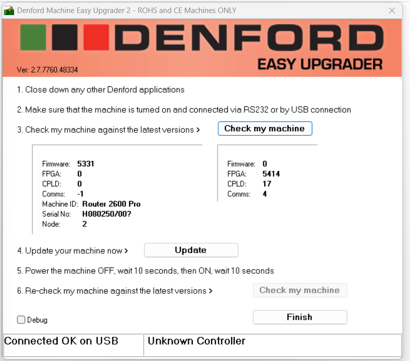

Hi Martin,
I can confirm Easy Upgrader seems to be connecting just fine - it tells me my machine is up-to-date, and shows the following information.
Left Box
Firmware: 5331
FPGA: 0
CPLD: 0
Comms: -1
Machine ID: Router 2600 Pro
Serial Number: XXXXX (the serial number is there, but I have left it out for the purpose of this post)
Node: 2
The right hand side shows
Firmware: 0
FPGA: 5414
CPLD: 17
Comms: 4
At the bottom of the screen it says "Connected OK on USB" and "Unknown Controller".
Thanks!
Screenshot 2025-12-11 195600.png (145.82 KiB) Viewed 565 times
