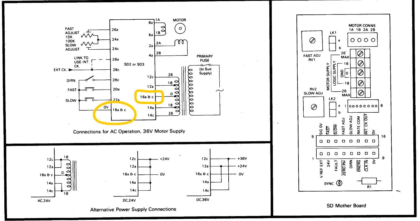

My understanding is that 0v on 32C is for the current programming resistor (32A --@R@-- 32C)
You probably won't need that so leave pins 32A and 32C alone.
The other 4 0v on 16 and 18 will be used for the logic inputs, ie the 0V side of the +24V output.
Like shown here:
Like shown here:
- parker-0v-connections.jpg (145.11 KiB) Viewed 13885 times
