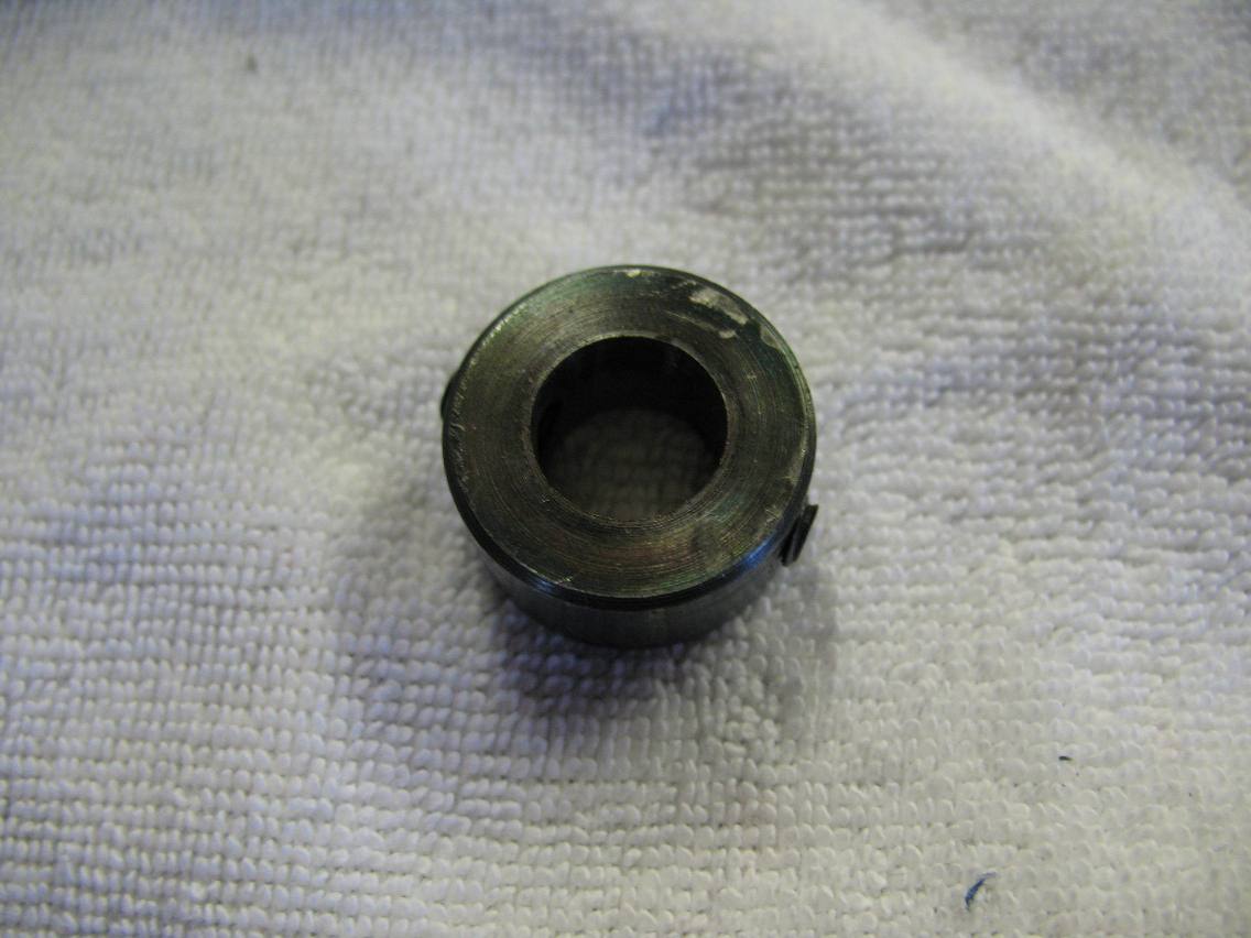

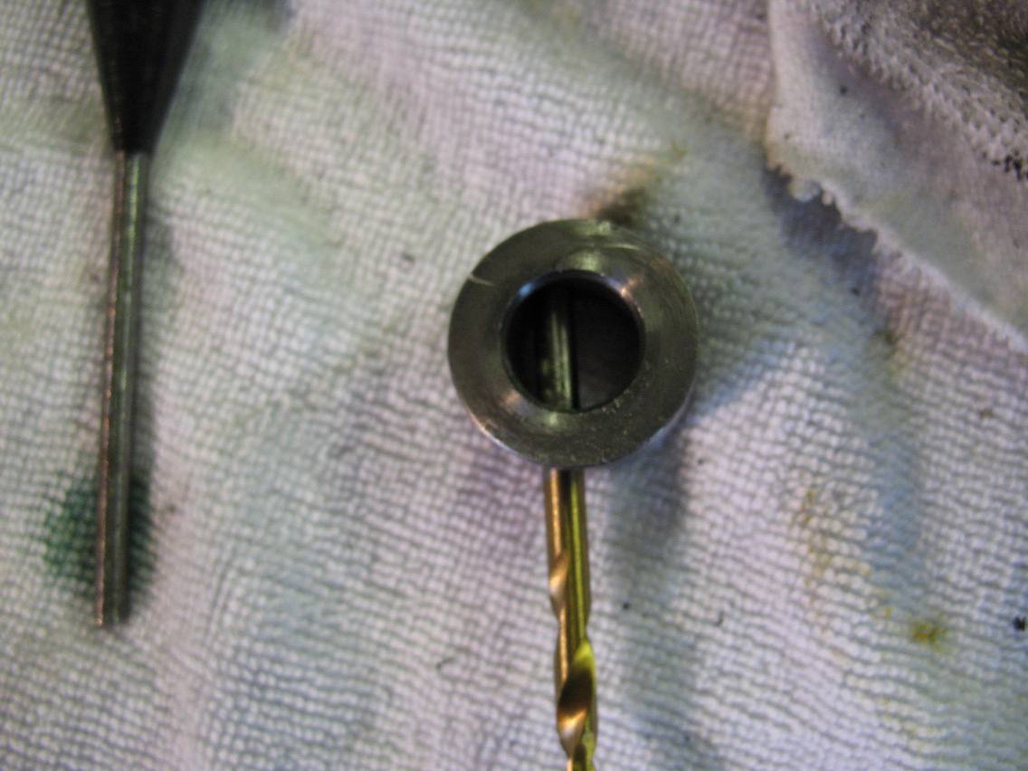

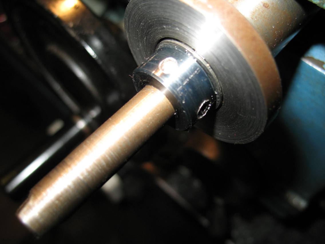

I made a new collar to retain the screw, and put two 4mm grub screws in it, that made assembly a lot easier. I was worried about getting the locking pin in straight, I needn't have worried, the original one wasn't in straight anyway.

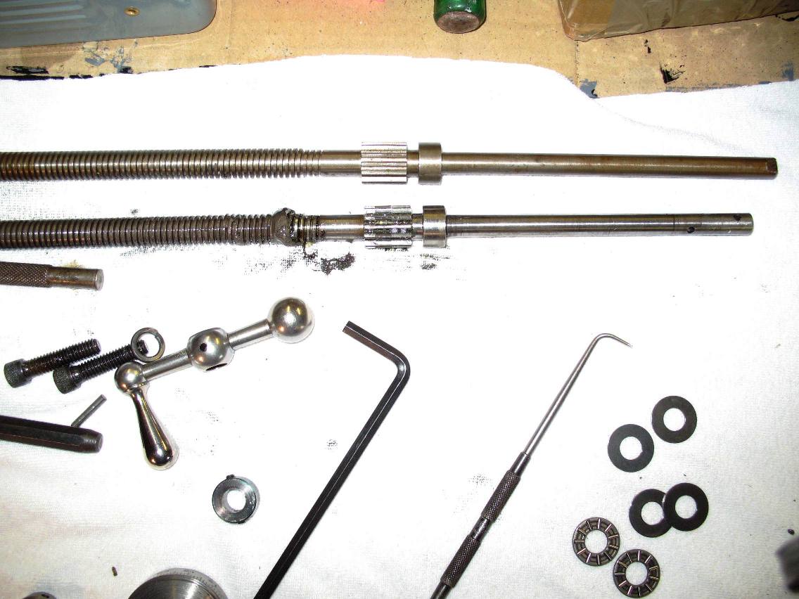

I took some pictures to help anybody else doing the same job.

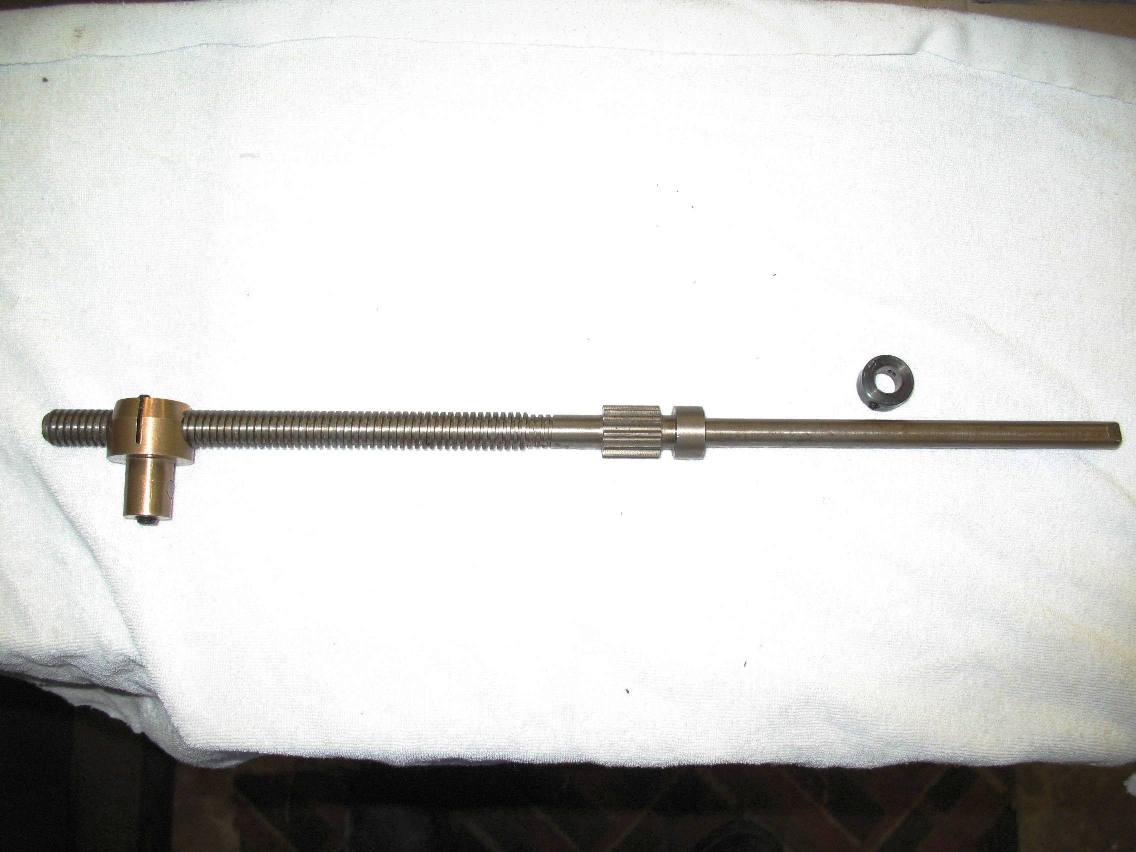

New screw in position.
original collar,not drilled straight anyway.
old and new, side by side.
New collar
New feedscrew and collar
