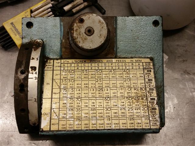

Is this the thing you need?

Yes thats the one i need

Ok send me a message with your address, pay the postage and it's yours.
I seriously recommend you make your best effort to change that front plate without removing the gear change lever though. It has an odd number of splines and teeth on the rack gear and if the pinion disengages it's easty to trash the gears by not getting it back in with full engagement.

Long shot here but can you remove that front gearbox cover without removing the gear selector lever.
