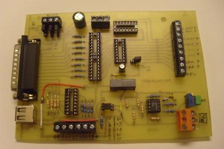

Hi to all.
Firstly thanks to all with the help on inputs / outputs. hi's or low's
After many nights work the first interface board for a starmill in now complete, just tested it out on the bench and works
realy well, the spindle speed control is now performing as it should, did find a slight glitch R18 in the above scematic
should go to +12v and not gnd. it is all opto isolated and electricaly isolated from the main 5volt supply, all the inputs / outputs are opto isolated.
at the moment it has 4 inputs and 8 outputs
Let me know if you re interested in the schematic and BOM for the board and i can send you a copy.
the interface should also work for the starturn lathe.

Okay, bit of thread necrophilia here but the drawings in this thread have proved extremely helpful, but I have a question. I see clearly the connections from the relay to the spindle motor but what has me totally stumped is the signal connection from Mach 3 to the board. Does this connect in any way to the 96 pin header? Any guidance with this would be gratefully received,
Many thanks.
dpslwk
Posts: 4
Joined: Sat 25 Jan , 2020 19:00 pm
Hardware/Software: Novaturn
VrTurning
Re: Starmill PC - Mach3 conversion and Tooling
Post by dpslwk » Fri 27 Oct , 2023 18:53 pm
stop-start wrote:
Mon 25 Sep , 2023 12:40 pm
Many thanks.
Enable and direction are wired via the 96way header but speed goes directly to the PWM board
