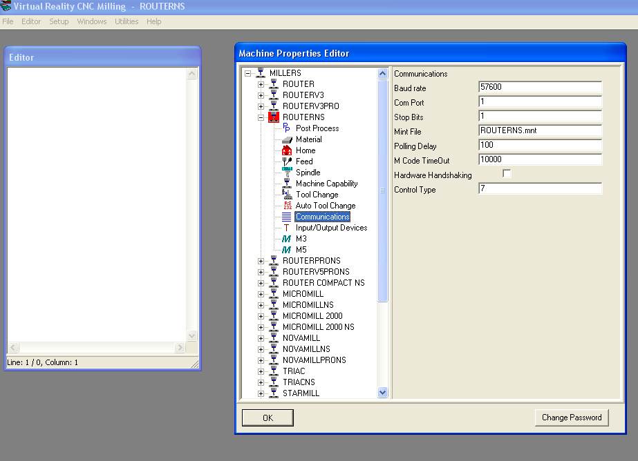

We tried 9600/4800/100 with the rest default, but got gibberish.
I found this post:
viewtopic.php?f=13&t=2281
Which I felt was a good hint, but it's still shooting out gibberish and not responding to the software. The software is vr milling v2.30.3.947.
I found this post:
Thanks,
Keith

Make sure the correct machine type is selected. Also Are you located in the UK or the USA? Have you got the correct external serial connection cable?

Nb - with that machine, be sure to pick MicroMill and not MicroMillNS - the default params for Micromill should find the machine straight away without any changes. (as long as the correct serial cable is used)
