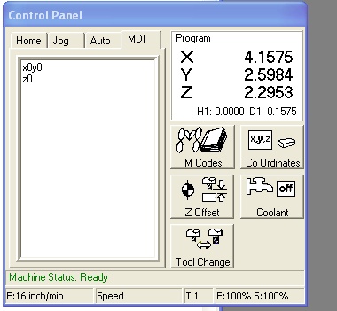

You can check the selected offsets by using the MDI (Manual Data Input) tab.
Click on the MDI tab and in the "White Box" type in
x0y0 (zeros) <enter>
z0
See attached jpg.
Then click on the Triangle "Start" button. The machine will move to Work Piece Offset that is "Active".

- MDI Tab.jpg (45.99 KiB) Viewed 13486 times
