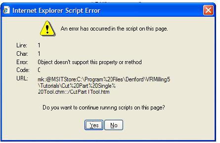

Post by Martin » Fri 14 May , 2010 14:32 pm
I have the same error.

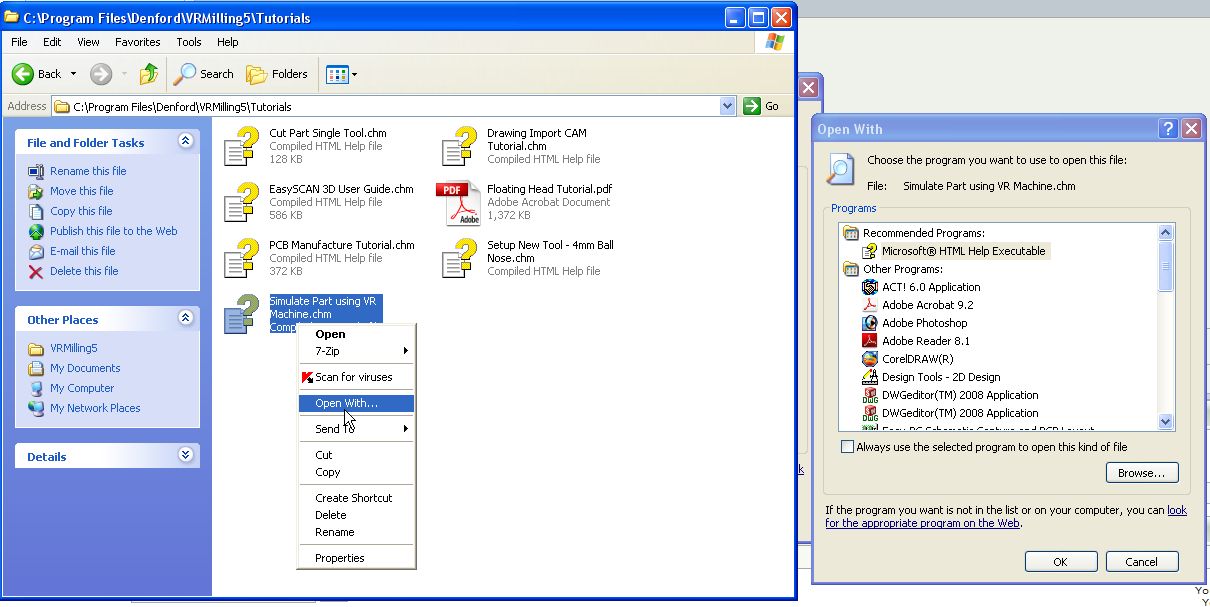

Post by Steve » Fri 14 May , 2010 16:20 pm
Go to the C:\Program Files\Denford\VRMilling5\Tutorials folder and see what is opening the file by default.
See attached screenshot
Can you open the ttorials by double clicking here?
