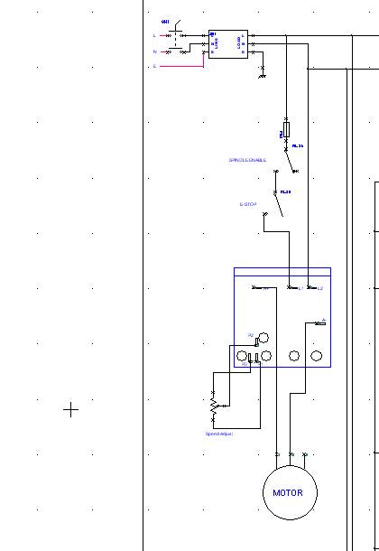

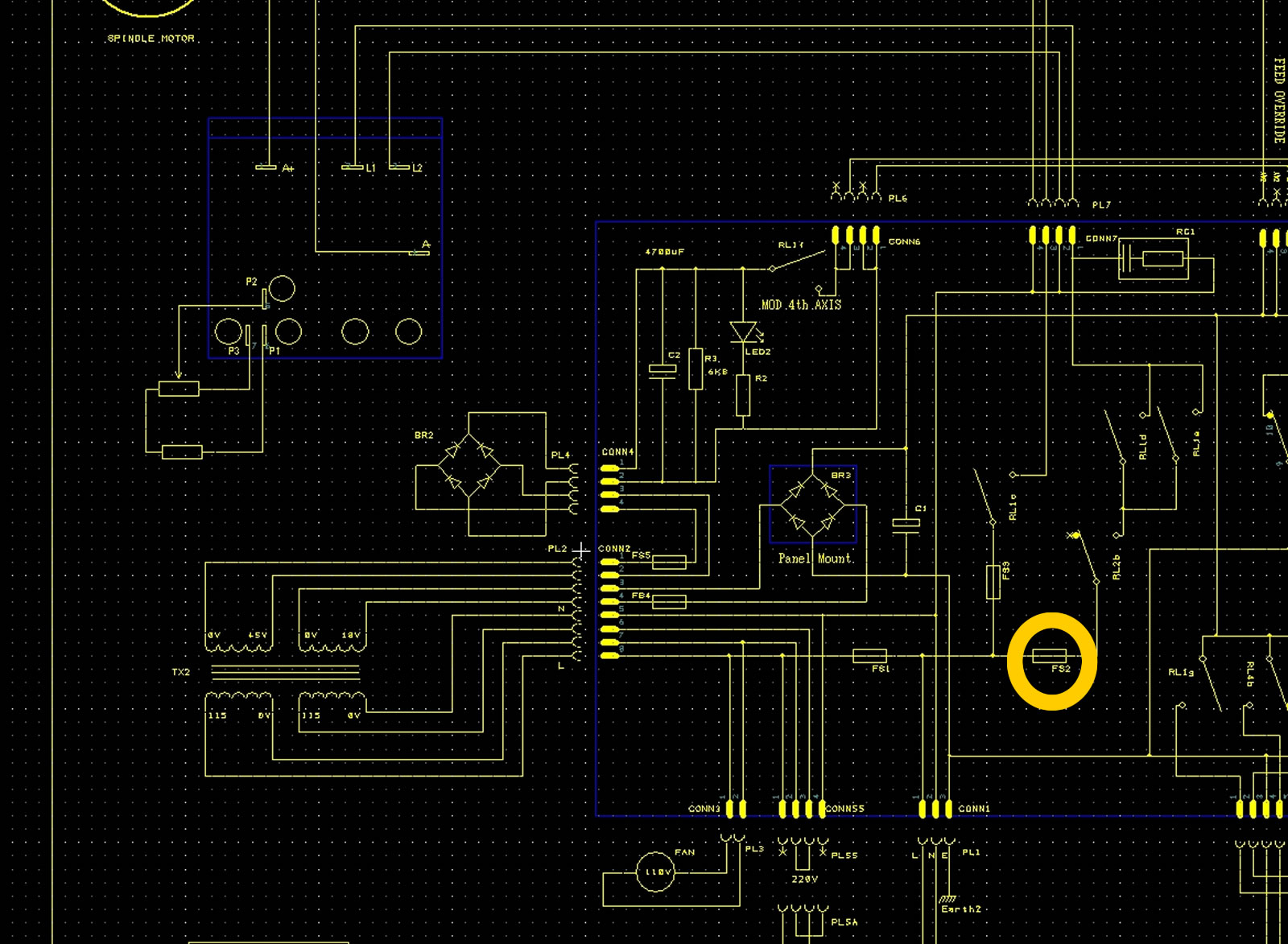

Post by Steve » Tue 10 Mar , 2009 10:48 am
Here is the schematic and overview of spindle circuit.
The Fuse is FS2 and i think it should be a 10A F rated fuse.
