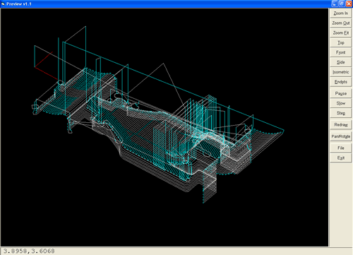

Proof that it works...
An F1 car toolpath produced by Denford QuickCAM Pro being previewed in G Code Interface for Davinci and C-series (Techno Inc)
