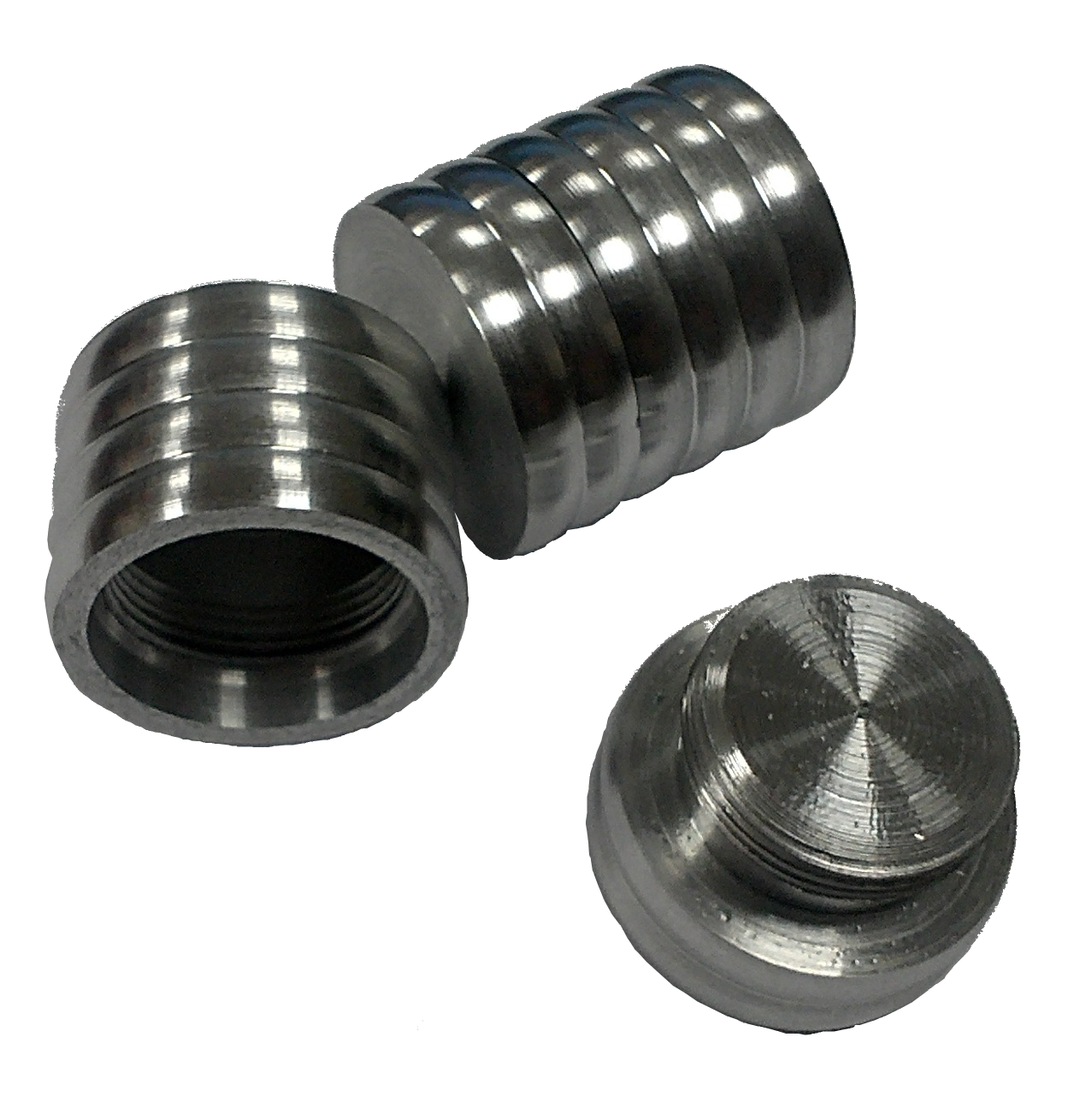

This is a program for the Turn 270 to produce a small pot with screw top lid.
For this I used a 50mm long, 25mm diameter aluminium bar.
Picture of the pots
Screw Top Pot.png (1.02 MiB) Viewed 21741 times
