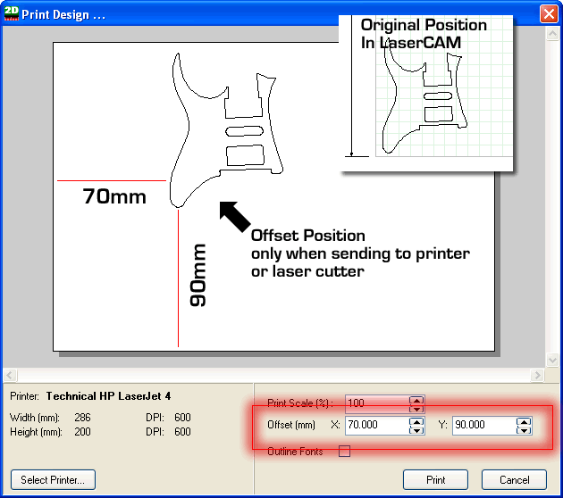

Recent question from a customer using LaserCAM 2D with a versalaser laser cutter:
Can you set different origins in terms of where the laser starts without moving the object/drawing in the original laserCam software. Currently I can only get it starting from the lower left corner
Post by Denford Admin » Fri 24 Nov , 2006 10:39 am
If you notice when you go to the print preview in LaserCAM, there are two boxes called offset (mm) X and Y.
Setting these values will offset the print output, but not alter the original drawing
See this image...
Offset the print output in LaserCAM and QuickCAM
