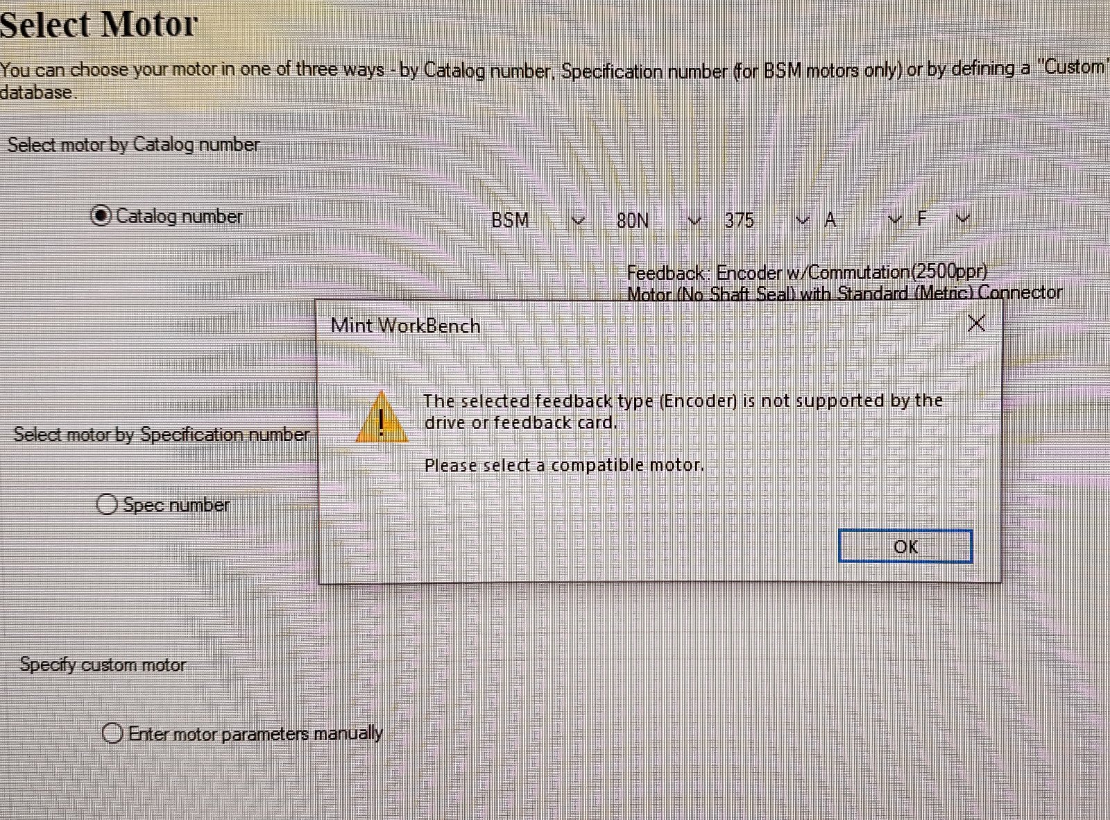

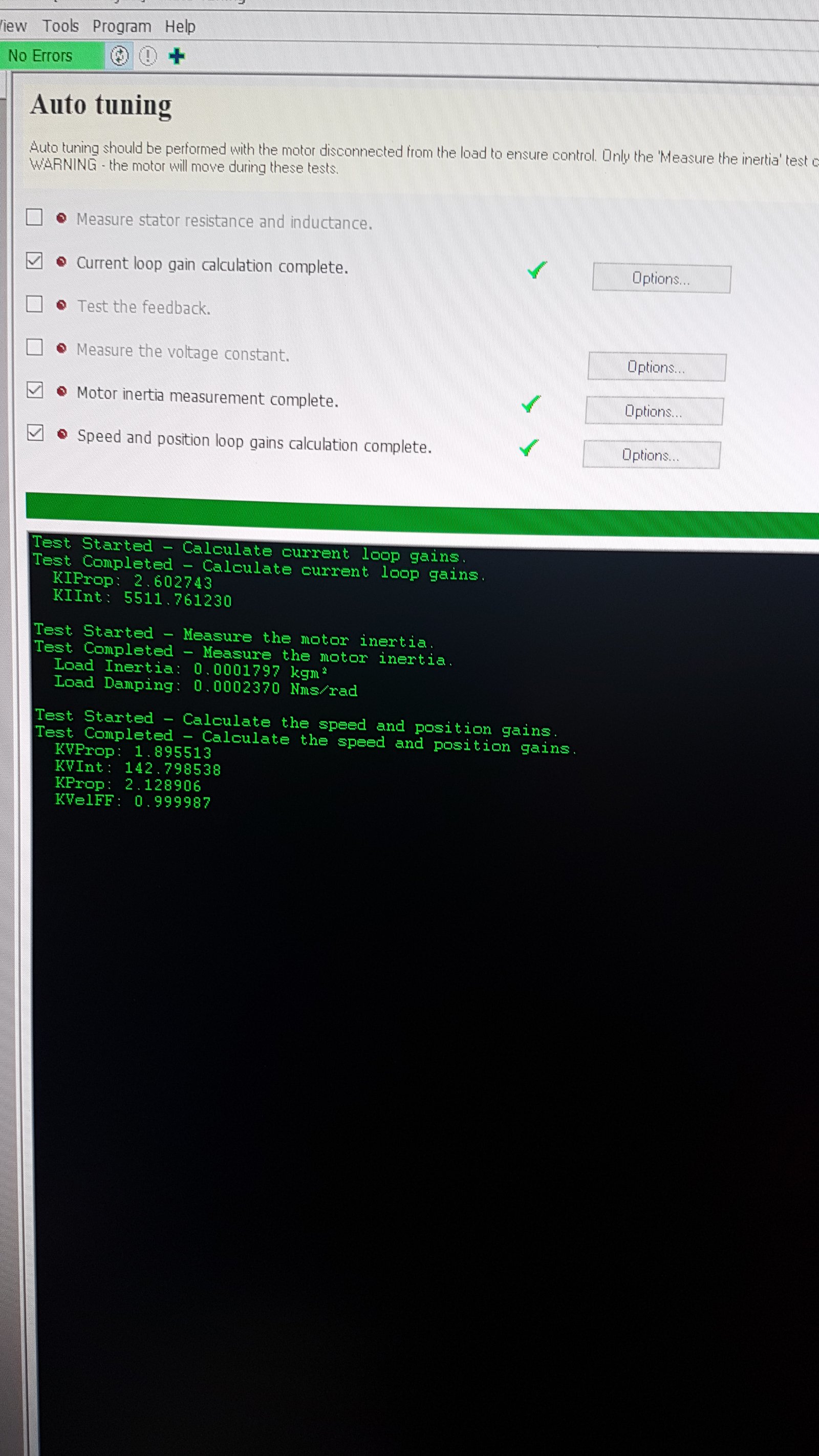

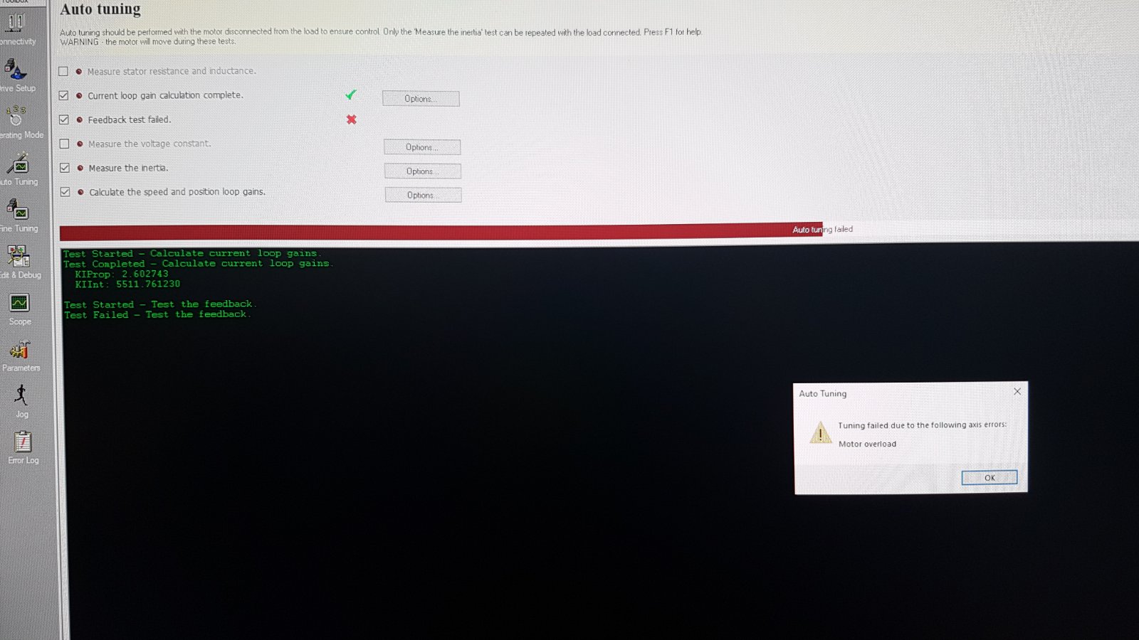

Hello, I'm new to the forum and need some help.
I'm in the process of setting up a servo drive and a servo motor in the Mint Work Bench environment.
There is a problem with the auto-tuning configuration;
(I will give some details)
-Windows 10 operating system
-Work Bench / Build number: 5860
-Servo drive. FMH 2A06TR-EN23
-Servo motor. BSM 80N-375 AF
Mint workbench informs that the motor encoder is not supported by the controller.
It also fail Feedback test. In jog, the motor runs irregularly at lower revs, an overload fault occurs.
I would like to ask for help and advice.
What firmware and how to properly upload it to the controller. What to do in case of error LED status 5 and 8 ??
