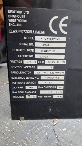

Can you post some pictures of the serial label & the control unit.

by Deck36
Novaturn-1 (Phone).jpeg (49.51 KiB) Viewed 14490 times

Martin wrote: Mon 03 Feb , 2025 9:28 am Can you post some pictures of the serial label & the control unit.
Done.

You can use a standard USB to RS 232 adapter connected to the original serial lead to connect to the machine.
If you email through to Technical@denford.co.uk we can give you a price for the licence for VR CNC Turning.
