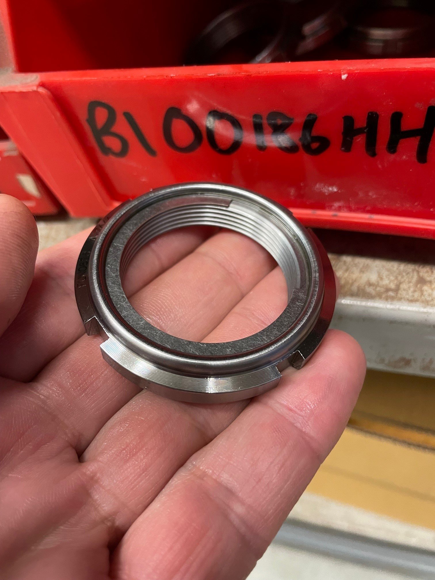

Is it the Locknut BI00186H that is coming loose?
We changed the style fitted when we designed the VMC1300. The new part is BI00186HH which has a spring steel locking plate on top. This could be fitted to your machine.
- bi00186HH.jpg (462.23 KiB) Viewed 22311 times
These are priced at £19
