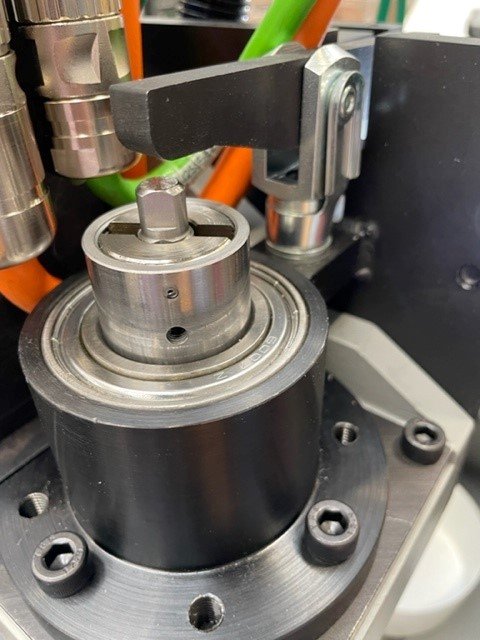

To remove the drawbar there are two nuts at the top that need to be removed VMC/0113 and VMC/0111 then the drawbar will fall clear of the spindle. Note there are four ¼” bearings that will fall out when the drawbar is removed. These should be stuck back in place with grease when refitting.
There are only a couple of things that could cause the tool to be loose:

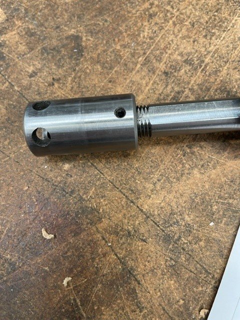

VMC/0106 the collet that holds the 4 bearings should be fitted so that 4 threads are left visible on the drawbar and then this is locked in place by a grubscrew.

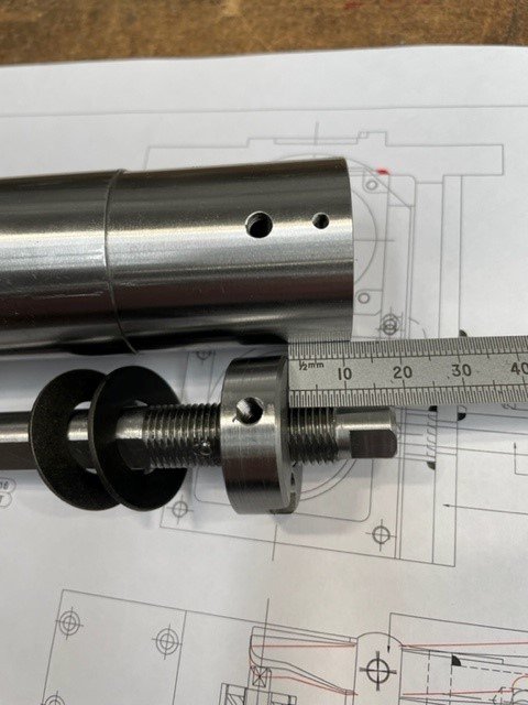

There are 44 springs in the spring stack and these should be fitted in opposite directions to each other. The first locknut (VMC/0111) is screwed down clamping the springs in place so it is 10.5mm below the top of the spindle then locked in place using a grub screw accessed through the hole drilled in the spindle. Then the second one (VMC/0113) is screwed in level with the top of the spindle and again clamped with a grub screw.

Just a note to say I serviced my VMC 1300 Pro drawbar using the info supplied and it cured by lose tooling problems. I made a spanner from an old imperial socket to turn the nuts. When replacing the drawbar, not the orientation of the flat on the bar and the indent in the spindle so you can slide the bar up. My Pro has 5 balls in the drawbar.

Unless they flipped over on removing, there were 3pairs of washers not opposed to each other…. Is this normal?
Is the 10.5mm dimension to top of the lower nut the same for all machines?
I didn’t take any measurements before disassembling…

None of the springs should be flipped they should all be fitted oposing each other and the 10.5 should be standard for all.
