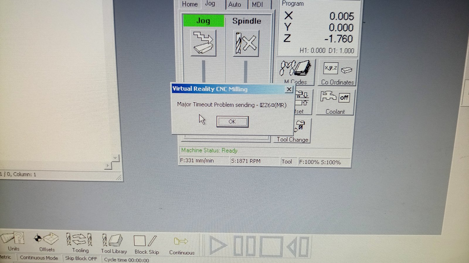

O also get this when the fault happens.
And then this when I click ok.
