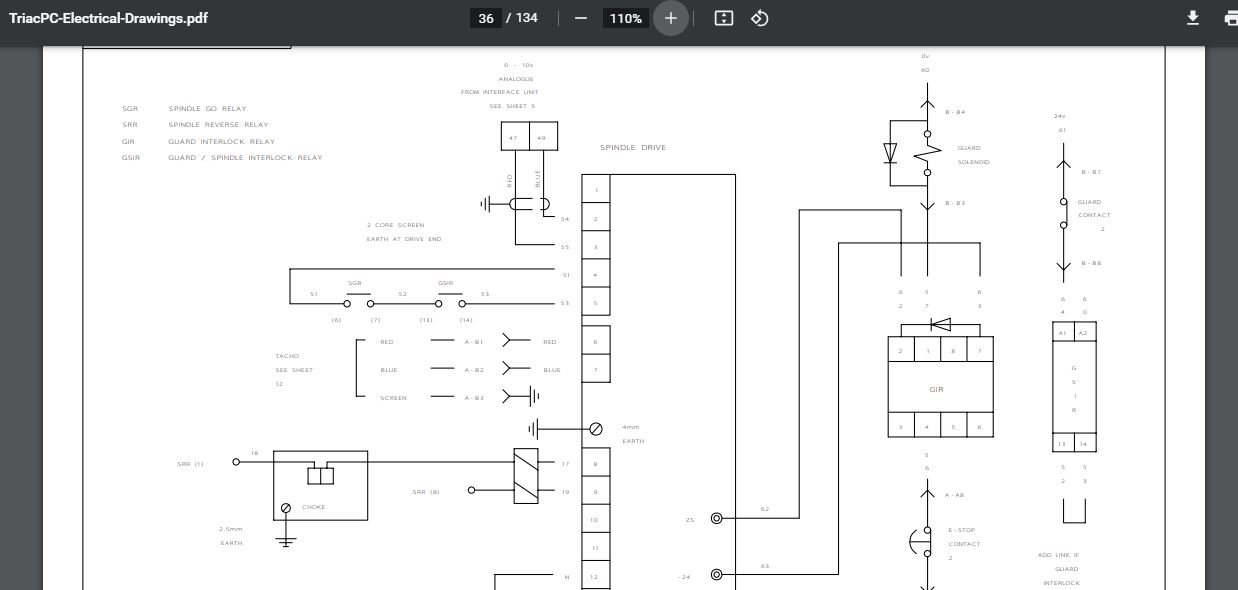

Please send a larger picture of the spindle drive.
Download electrical diagrams
file:///C:/Users/soddy/Downloads/TriacPC-Electrical-Drawings.pdf
View page 36
Wires 54 and 55 are the analogue
spin drive.JPG (46.2 KiB) Viewed 156698 times
Wires 17 and 19 look like the motor DC

Steve wrote: Fri 21 May , 2021 13:34 pm Please send a larger picture of the spindle drive.
View page 36
amaxlegend wrote: Fri 21 May , 2021 18:24 pm The voltage on those Pins 54 (-) and 55 (+) at 250 (slowest speed ) is 4.6 -4.78 DC , fluctuates
the voltage on the pins at 4000 (highest speed ) is 6.7 - 7.32 DC , fluctuates
It doesnt get near to 10vdc on full speed
wonder why that is ?
regards Alex
Hi Steve cant realy read this as its a bit blurred any chance you could send me the pdf for the Triac as it would be useful to have. do you have any other documentation on the triac
regards Alex
