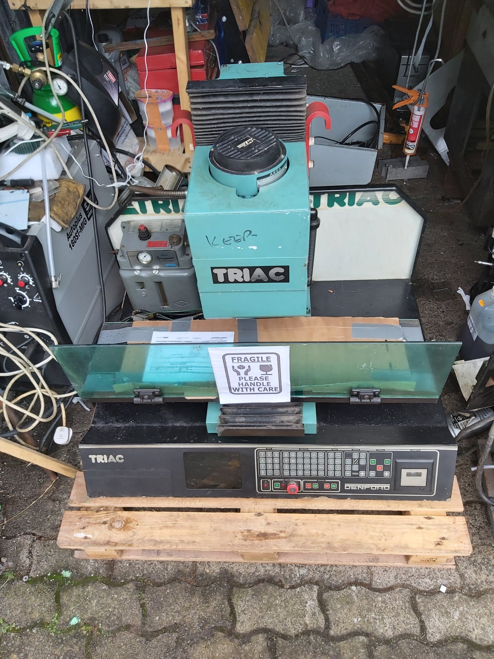

After roughly 10 years I finally have myself a second denford mill, having managed alright so far with a novamill it's nice to get my hands on somthing slightly more substantial. I have considered drip feeding or dnc to the original control but frankly I think it's still too limiting for what I want to do. I'm sure these early machines have be converted to mach3 or linuxcnc plenty of times. I was wondering if the stepper drives a worth using or should I just forget it and pick up some new ones. I will be replacing them long term anyway but would like to be able to get the machine working before investing more into it. I know it's easy done on the novamill with the 96 pin header but what about these relics?

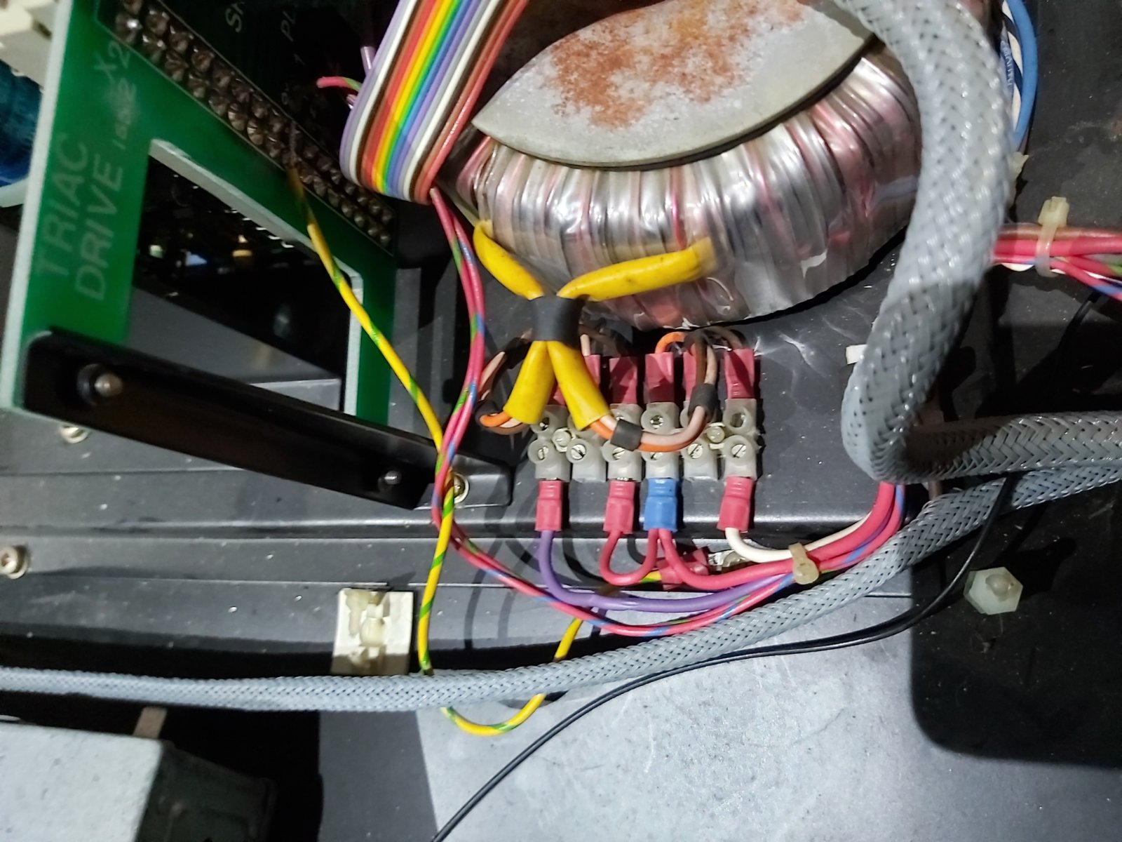

Does anyone happen to know what the primary taps are on the drives toroidal transformer?
I have a purple, red and white to the primary, with red jumpered to a second terminal. Trying to get power to this without releasing any magic smoke. Also, what role does the contactor play? E-stop?
