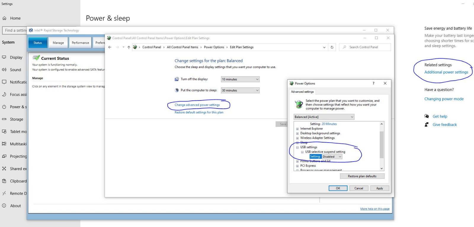

Have you checked the power saving settings on your PC? Make sure the USB port does not shut down in power saving mode
power saving.JPG (118.55 KiB) Viewed 28460 times

Thanks for the reply. On your advice, I changed the settings and ran another program and the same thing happened. :(
One obervation is that, after the machine stops, the PC no longer recognises it at all. I can't reconnect without rebooting. This surely measn it's not a "move buffer full" comms issue but, more likely a Timeout issue. Some parameter is cutting the connection between CNC & PC altogether. This is why your suggestion was so promising but, alas, no dice.
