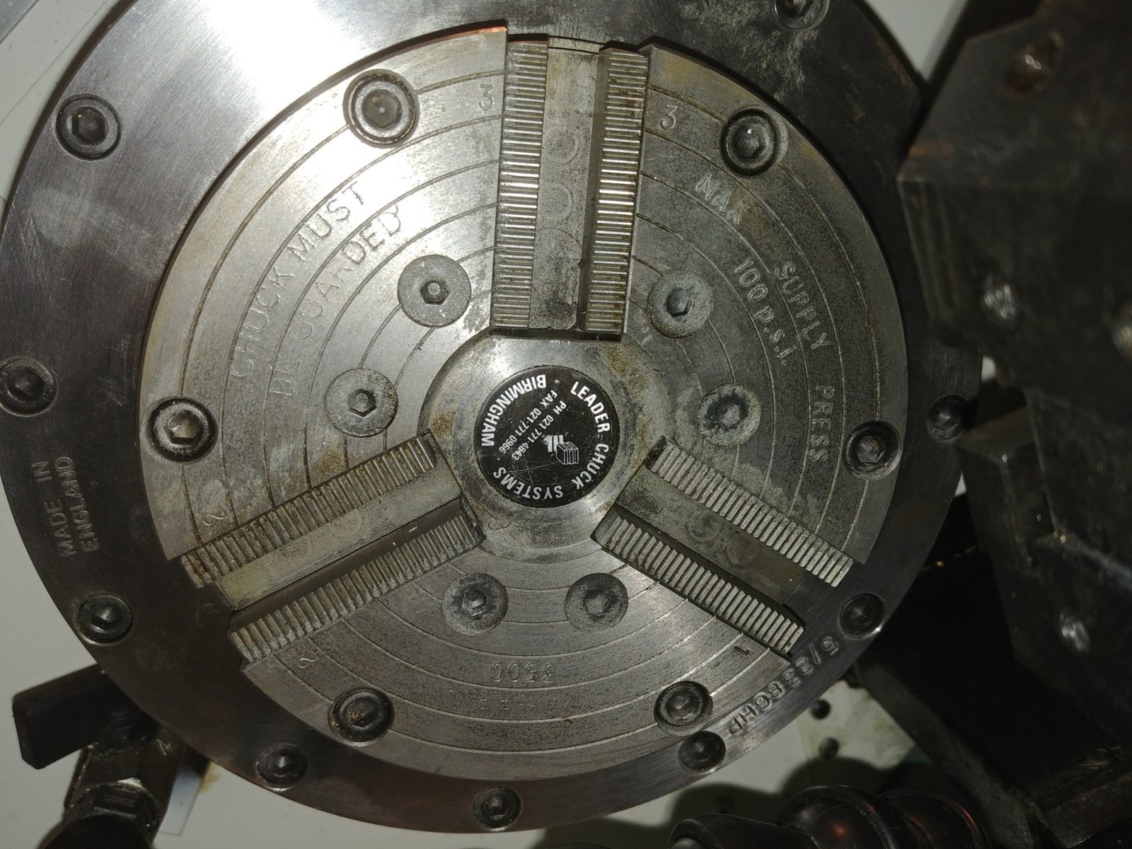

I have a Denford Cyclone U fitted with a 130mm (~5") Leader pneumatic air chuck:
Leader chuck.jpg (380.21 KiB) Viewed 27388 times
I would rather have a manual chuck so I want to replace this one (and sell it on). However I'm not sure how to remove it as there are so many bolt heads on its face as compared with a regular manual chuck. Also it seems to have an abnormally large 8" backplate.
Does anyone know how to remove this chuck and what mount I need on a manual chuck replacement?

What is the largest manual chuck anyone has put on the Cyclone? The spec plate says 150mm max but that seems to be a non-standard size. So I've got the choice of either 125mm or 160mm. I would prefer the 160mm but would that cause a problem? I found out that the 200mm (~8") backplate is actually an oversized piston plate.
