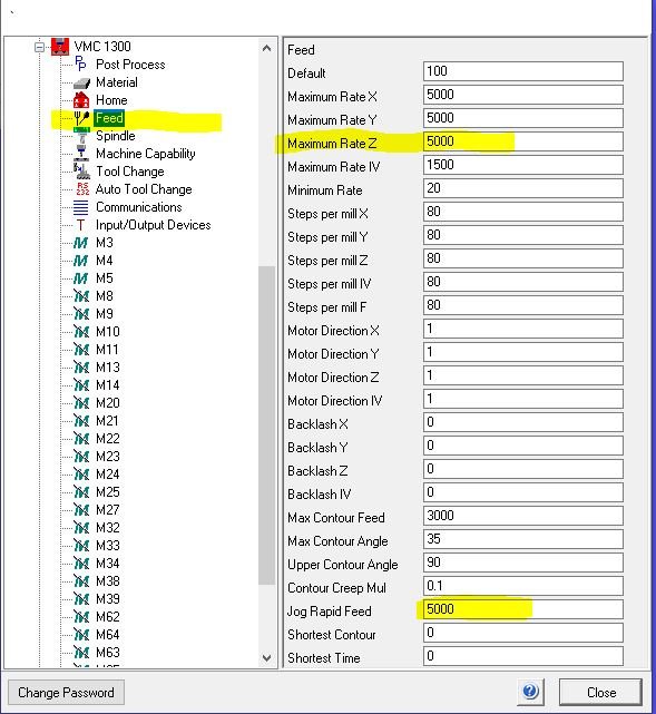

If you go into Setup machine parameters enter the password of denny
you can then reduce the Z maximum feedrate but I would also reduce the max rapid rate to match this.
If you set it to 3000 or 4000 I think this will be fine.

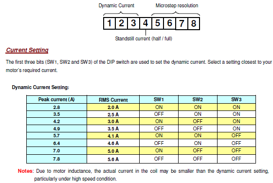

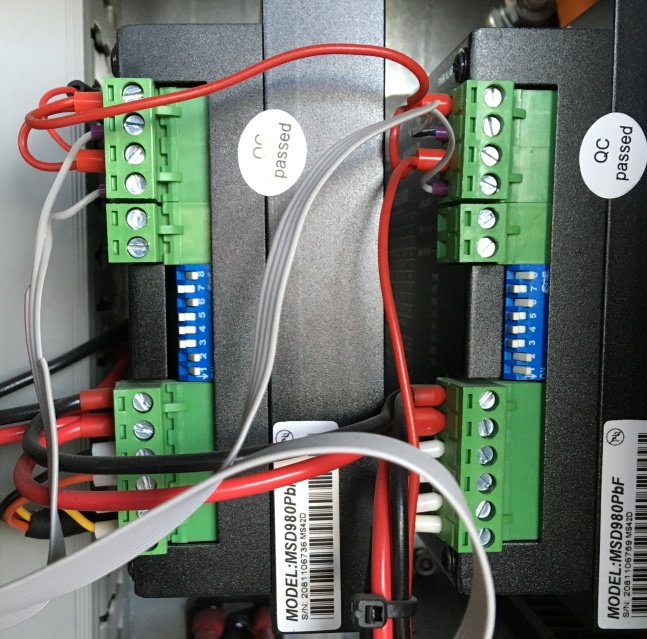

If you take a photo of the stepper drives in the back of the machine there is a current option on the Z axis that can be changed.
The settings are by default:
MSD880
1 OFF
2 ON
3 OFF
4 OFF
5 OFF
6 OFF
7 ON
8 OFF
5000 Pulses/Rev 4.6A RMS
I would just lower the rapid on all 3 axes to 4000mm / Min and all will be well.

I am up to date with V5_68
My drives are set:
1 ON
2 ON
3 OFF
4 OFF
5 OFF
6 ON
7 OFF
8 ON
Which the datasheet tells me is 5.7 Peak, 4.1 RMS, so one setting softer than your default listing

Set as our default should help.

I did the adjustments per Steve's posts and added the heater on lowest setting and now can home and toolchange without issue. I'm happy the G28 goes to top of Z before homing X and Y. Thanks both
