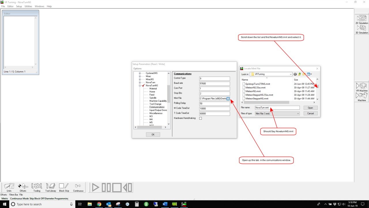

If you open up VRTurning & then open up the Setup Parameters (password is denny) you will need to change the mint file in communications for the Novaturn NS. It should read
C:\Program Files (x86)\Denford\VRTurning\NovaTurnNS.mnt
& not
C:\Program Files (x86)\Denford\VRTurning\NovaTurn.mnt

Martin wrote: Fri 31 May , 2019 9:55 am If you open up VRTurning & then open up the Setup Parameters (password is denny) you will need to change the mint file in communications for the Novaturn NS. It should read
& not
Thanks, I tried that but still no joy.
select mint.jpg (75.15 KiB) Viewed 33165 times

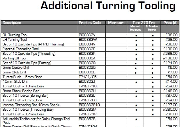

Any advice on where to buy tools would be greatly appreciated! I need a boring tool and parting tool.

by Steve
tooling is available from Denford.
tooling 2019.JPG (80.57 KiB) Viewed 33109 times
