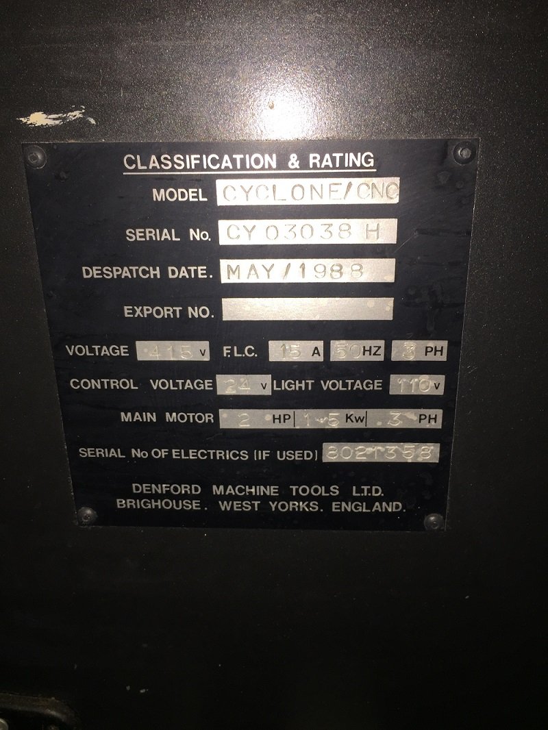

Martin wrote: Mon 04 Mar , 2019 8:44 am What is the of the machine? We may still have a copy.
Hello
serial number CY03038
2019-03-04 18.27.18.jpg (144.54 KiB) Viewed 24816 times
Re: Lost zero parameters on Fanuc OT-B
Posted: Tue 05 Mar , 2019 10:38 am
by Martin
I can only find the original Fanuc Data Sheet & the electrical record sheet for this one.
