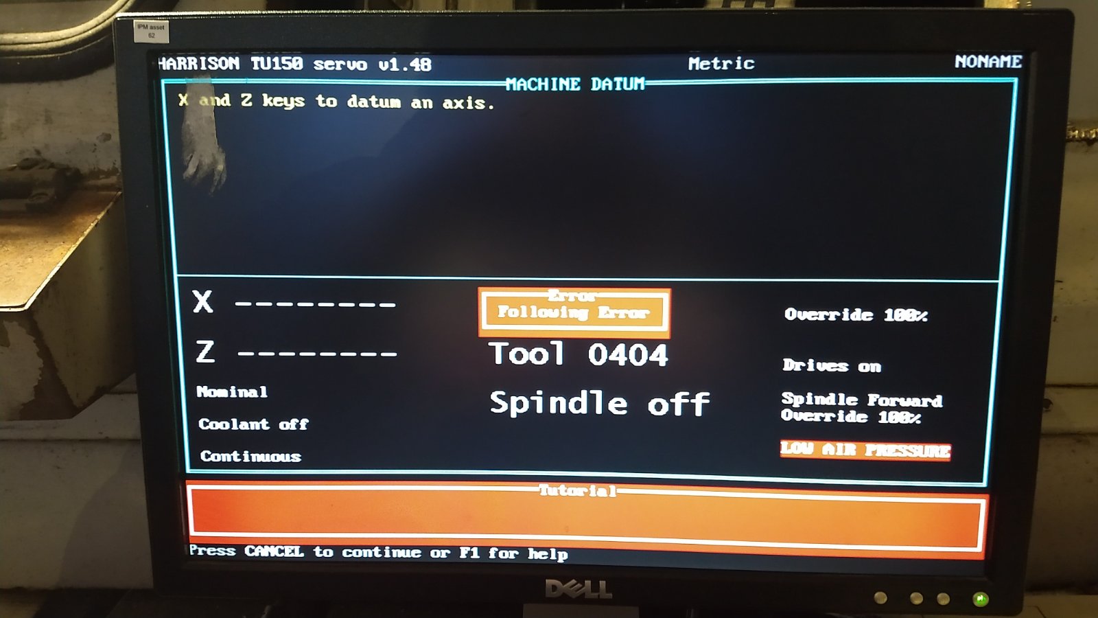

Hi All I am back again.
Things have moved on a bit, I downloaded the files Martin suggested and created a DOS boot disk with it all on and it powered up and the X axis shot to the max and jammed there with a jolt, the z crept forward toward the chuck. Estop put a stop to its fun.
My question, is this the correct software if so what do I need to change to make it work right.
The machine is fitted with an air chuck and 8 station tool changer plus a part catcher.
The other thing is even with 100psi it thinks the air is low, I checked the switch and its working fine so I guess its a setting or the wring input is being checked.
Any help would be very well received.

Re: TU150U in need of TLC
Posted: Sun 03 Feb , 2019 23:40 pm
by TDIPower
Was the movement as soon as power went on or did you press anything.
Does it have limit/home switches? When the machines I have worked on power up they sit there, you have to press home for movement,
If the location is away from home it drives to the home location at pace, presses the switch, stops, then slowly moves away until the switch is released.
Sounds like it trying to go to home in one direction and move away from home on the other. So worth checking the switches/cables
Could be wrong though
Posted: Mon 04 Feb , 2019 19:25 pm
by rasp
Pete,
as soon as the control screen was displayed the x axis set off and hit the end stop toward the home position, the z was also creeping toward the chuck away from home.
Martin, Thank you I will give it a go but they look almost the same as what is in it at the moment.
Graham
Posted: Mon 04 Feb , 2019 21:19 pm
by TDIPower
That sort of sounds like home switch issues BUT only if you had called for a home. Got to be worth checking the functionality of them.
Posted: Wed 06 Feb , 2019 1:07 am
by rasp
Well its looking like a duff Mint card, as soon as the machine becomes ready the mint sends out a voltage on the analogue and off it sets at rapid in X and at creep in Z.
Anybody have an old Mint card they don't want?
If not Mach4 here we come!
Graham
