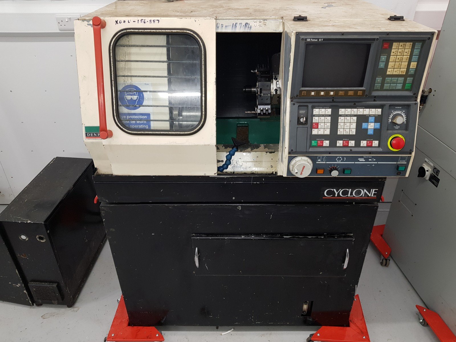

I previously owned an Eazyturn3 - which was fantastic (post Mach3 conversion). The only thing I didn't like was no ATC.
I've now bought a Cyclone which is obviously a much more grown-up machine.

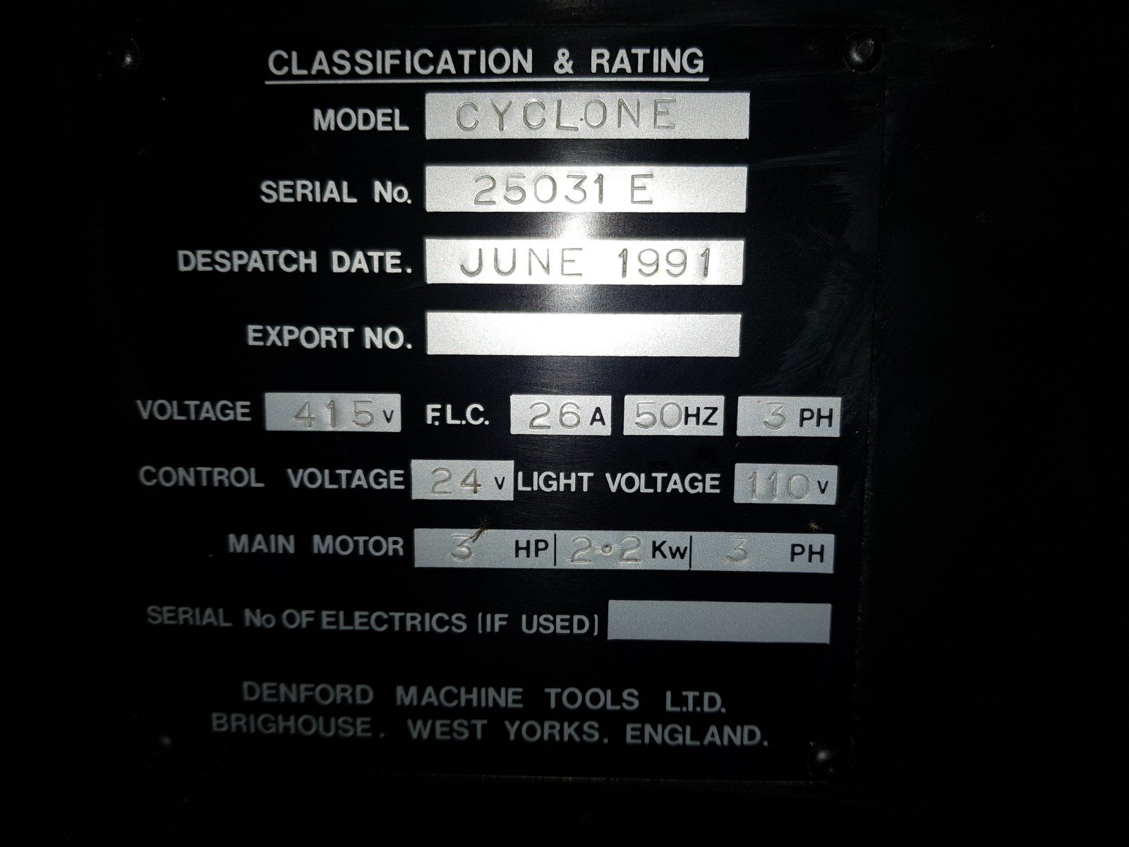

I don't know much about it - I don't even know the model number! I'm hoping the serial number above will shed some light on it.
I need to run it on a phase converter of some sort. I need some advice on that front. I've read everything I can find on here - and the only info was that I'd need a 10Hp / 7.5kW converter - though it wasn't clear if the person suggesting this had actually done it or was suggesting based on the spec?
The rating plate says 415V at 26A (32kW?) which seems high even as a worst case startup current. I presume the VFD on the spindle can be tuned down a little to bring this into the realms of realistic budgets.

The current quoted in the literature as well as on the rating plates seems random! I've seen rating plates as low as 16A and up to 29A where the literature is generally 16 to 20A.

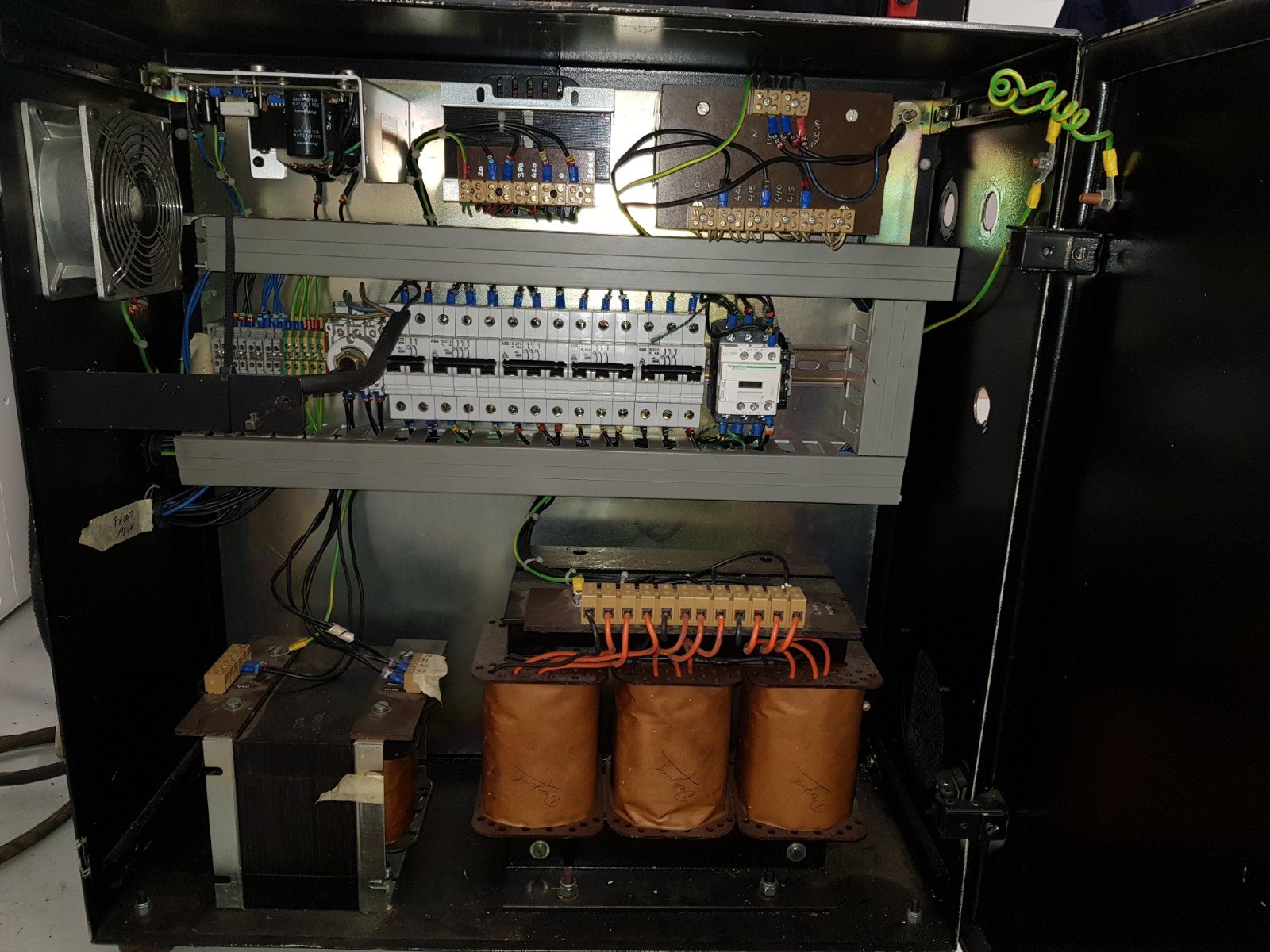

To make yours run, you will need a 10Hp / 7.5kW Phase converter. I used a digital converter, I don't know if it will work with a rotary, but it seems likely.
The Cyclone needs 415v to operate, but can be made to run on 230V 3 Phase (see later).
The simplest option is to buy a 415V, 10Hp converter and add a 3 Phase Choke (which cleans up the noisy output of your phase converter so it doesn't upset the CNC pixies. I bought a 7kw, 3mH 3Ph choke on eBay for £40 (used).
You will also need to increase the carrier frequency of the converter from 3khz (or whatever it's default is) to around 12 to 15kHz. This makes the choke work better - and keeps the pixies happy.
There's no need to use a 'special' CNC converter - inside the box is just a phase converter and a choke. It is not worth the £2k price difference!
A suitable 415v phase converter will cost around £1000. However, there are cheaper options!
I bought a Santerno SINUS M 10Hp Phase converter for around £500:
https://inverterdrive.com/group/AC-Inve ... 0V-Single/
It spits out 230v - but we need 415V. There are two options for this:
Find a 3Phase 220V to 415v transformer. While the phase converter needs to be 10Hp / 7.5kW to supply the high start current, the transformer doesn't need to be that big. 4kVA is plenty as the highest continuous power I've seen the lathe draw is 2.5kW. These are often found on eBay, having been stripped out of CNC Machines.
But wait a minute! Inside the transformer box, there is just such a 4.5kVA 3Phase 220V to 415v transformer - why can't I use that?!
Well, with a bit of re-wiring ans one additional contactor you can. Inside the Cyclone, it's used to supply 220V to the servo drives & spindle from the 415v input. I figured these could run off the phase converter and I could use the transformer to step up the 230V to 415v to run everything else. This does require one additional contactor:
https://uk.rs-online.com/web/p/contactors/6851542/
The new contactor uses the output of the MDC to power it's coil and connects 230V from the phase converter to the axis & spindle drives.
Originally, I left these powered continuously (not switched at the same time as the MDC) but it confused the pixies.
I've attached the modified circuit for the transformer box.
If you have any mains filters in the transformer box, remove them! They will overheat and the smoke will escape, connected to an inverter. Te choke you have added does the same job.

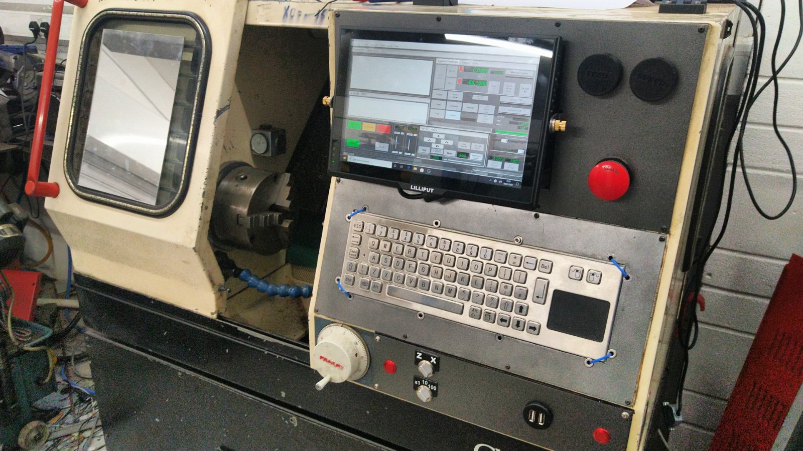

I've now finished the Mach4 Conversion - and it works well, including threading & Rigid Tapping.
I've used a CSMIO-IP/S which will talk directly to the OE Spindle Encoder.
2 x Allen Bradley Ultra3000 Servo Drives which will directly control the original Fanuc Red Cap Servo motors, with Step/Direction (or 10V Analogue if you want).
The Toolchanger, I think because it's old, was much simpler to control than some. It has just 4 outputs (of which only 3 are used) for the binary position of the turret, a brake (24V) input and 3Ph 115V in for the motor. I wrote a very easy toolchange macro in Mach4 which works reliably.
I think,the hardest part (other than research to find pinouts of the motor etc connectors) was that I had to make my own 3Ph 300VA 230 to 115V transformer out of 3 x single phase transformers connected together. I just couldn't find one to buy that was affordable and/or small enough.
Cyclone After.jpg (327.73 KiB) Viewed 43479 times
If any of you are thinking about a similar conversion, I'm very happy to answer questions. The setup of the Ultra3000 drives is easy once you know what you're doing - and I can help with that too.
I Plasma cut the replacement control panels. The Keyboard is held in with cable ties as I had an earth-loop problem and I wanted to try isolating it & earthing separately. However it was something else, so it's now earth bonded to the chassis. I've not got around to replacing all the mounting screws yet.
It's probably the most challenging conversion I've done yet - but the end result is really good. No better than the original Fanuc in operation, but no worse and a lot more user friendly!
