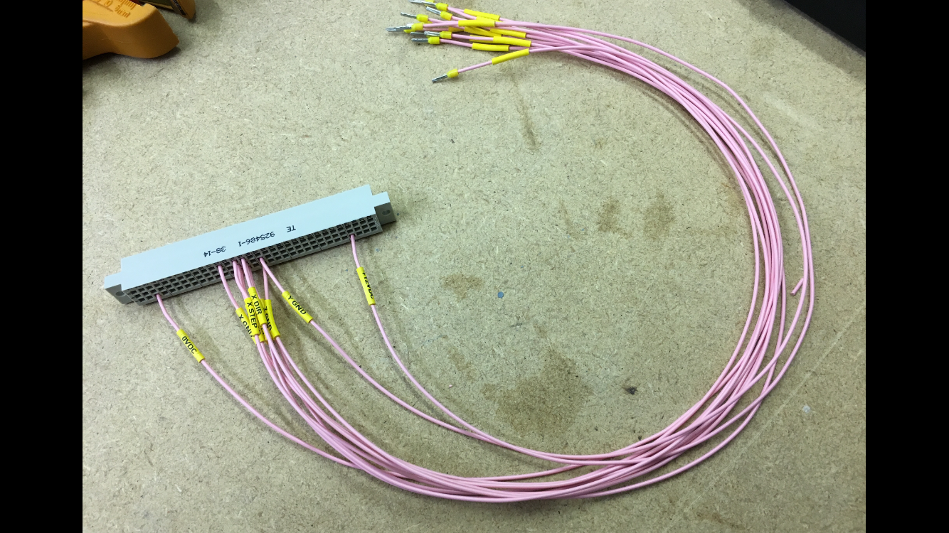

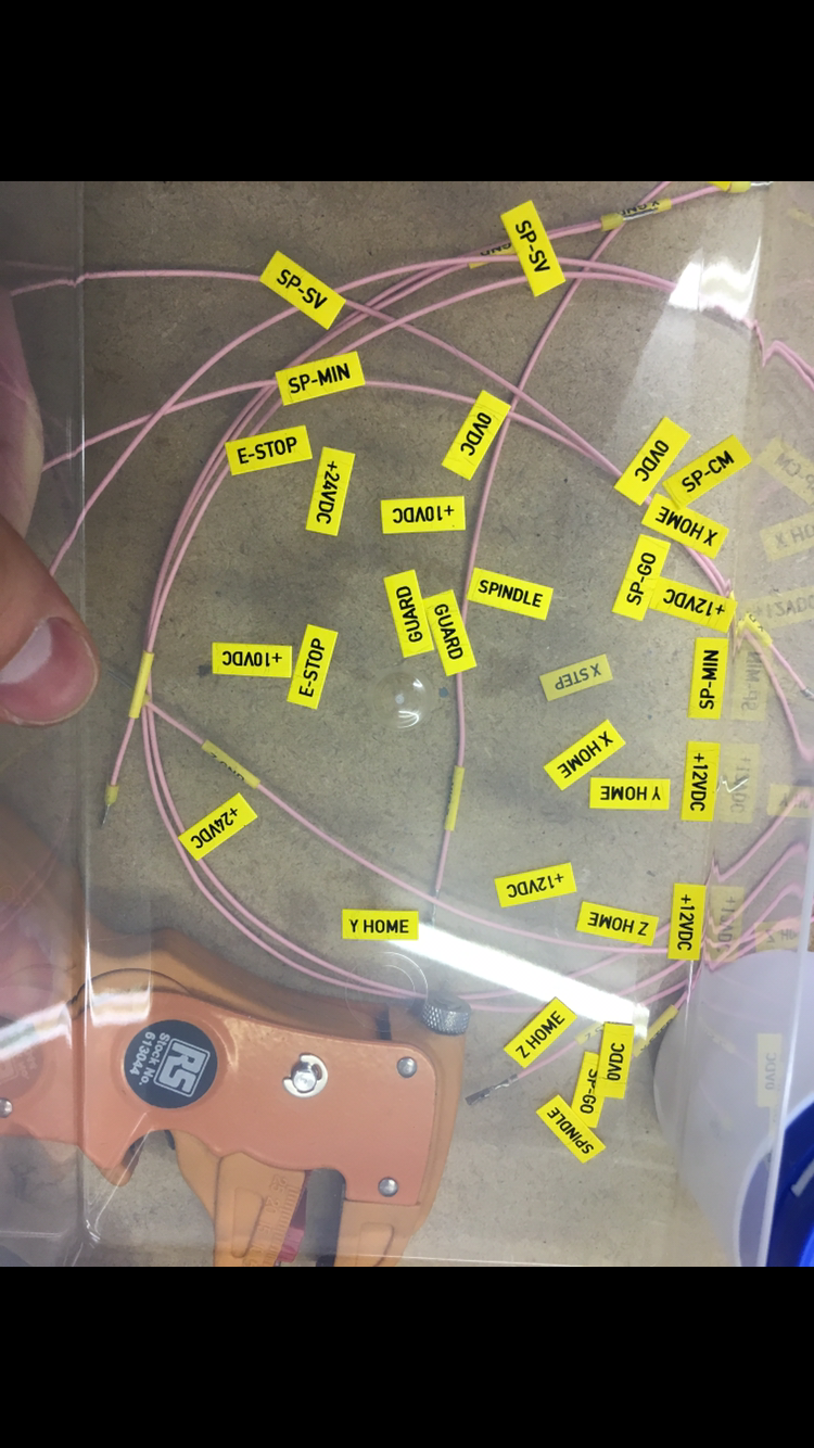

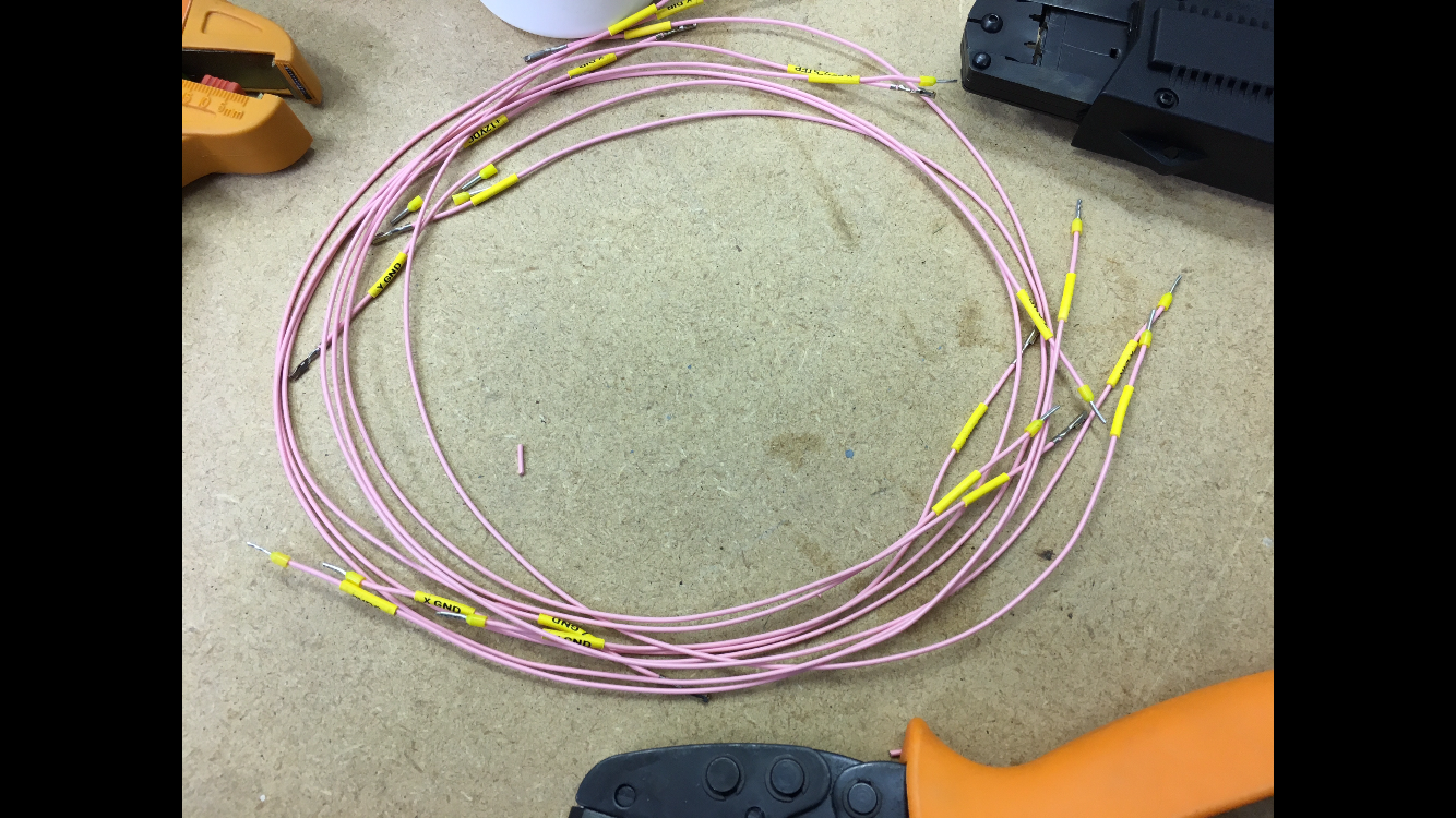

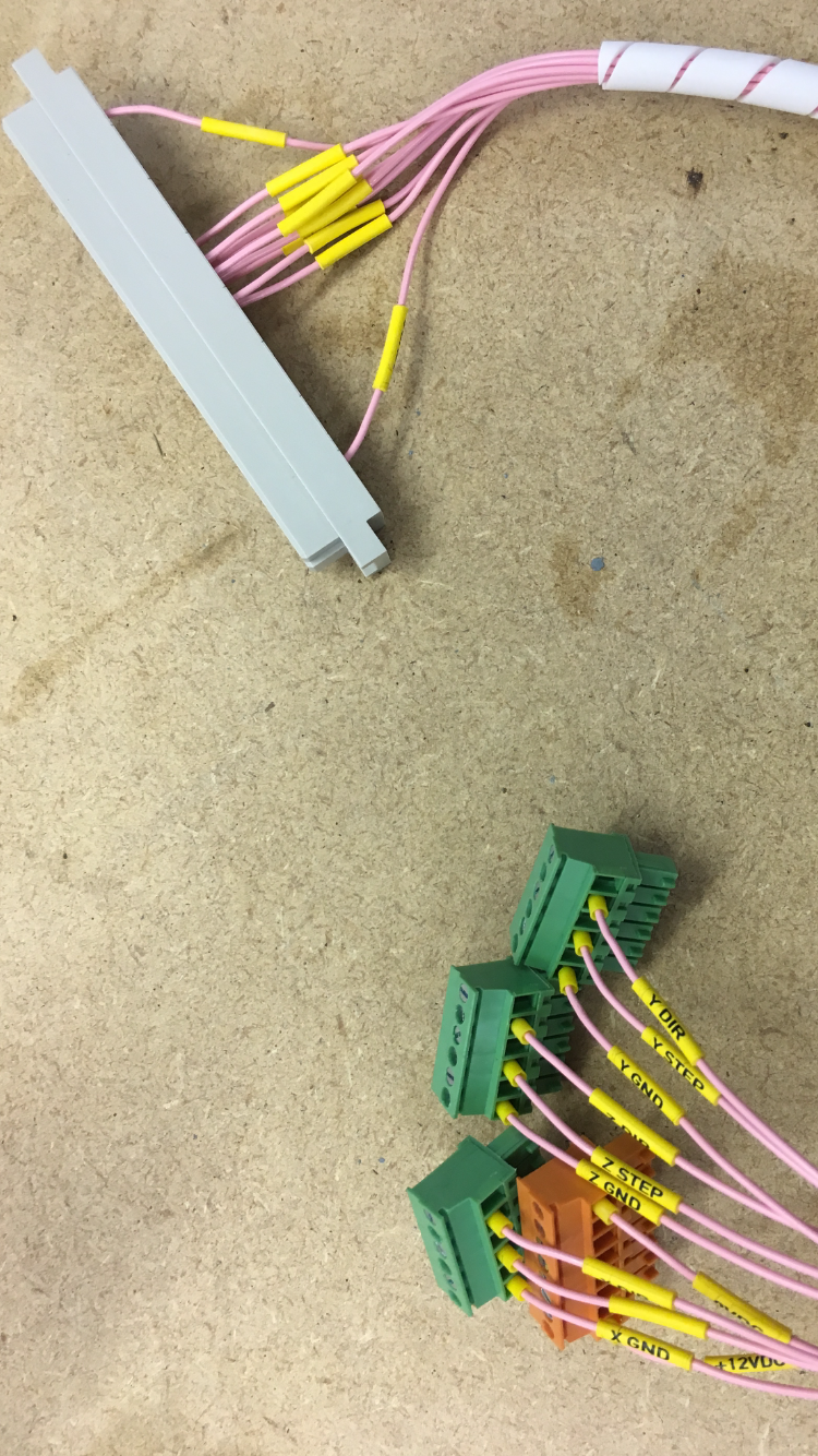

New cable loom to plug into the Eurocard 96-way plug.
TE connector housing with TE crimped connectors. Printed heatshrink (yup, have the machine for that) and will be using mesh wrap once the loom is complete.
The limit switches need rewiring as the MESA is sinking not sourcing, but that's an easy job of a few DIN rail terminals.

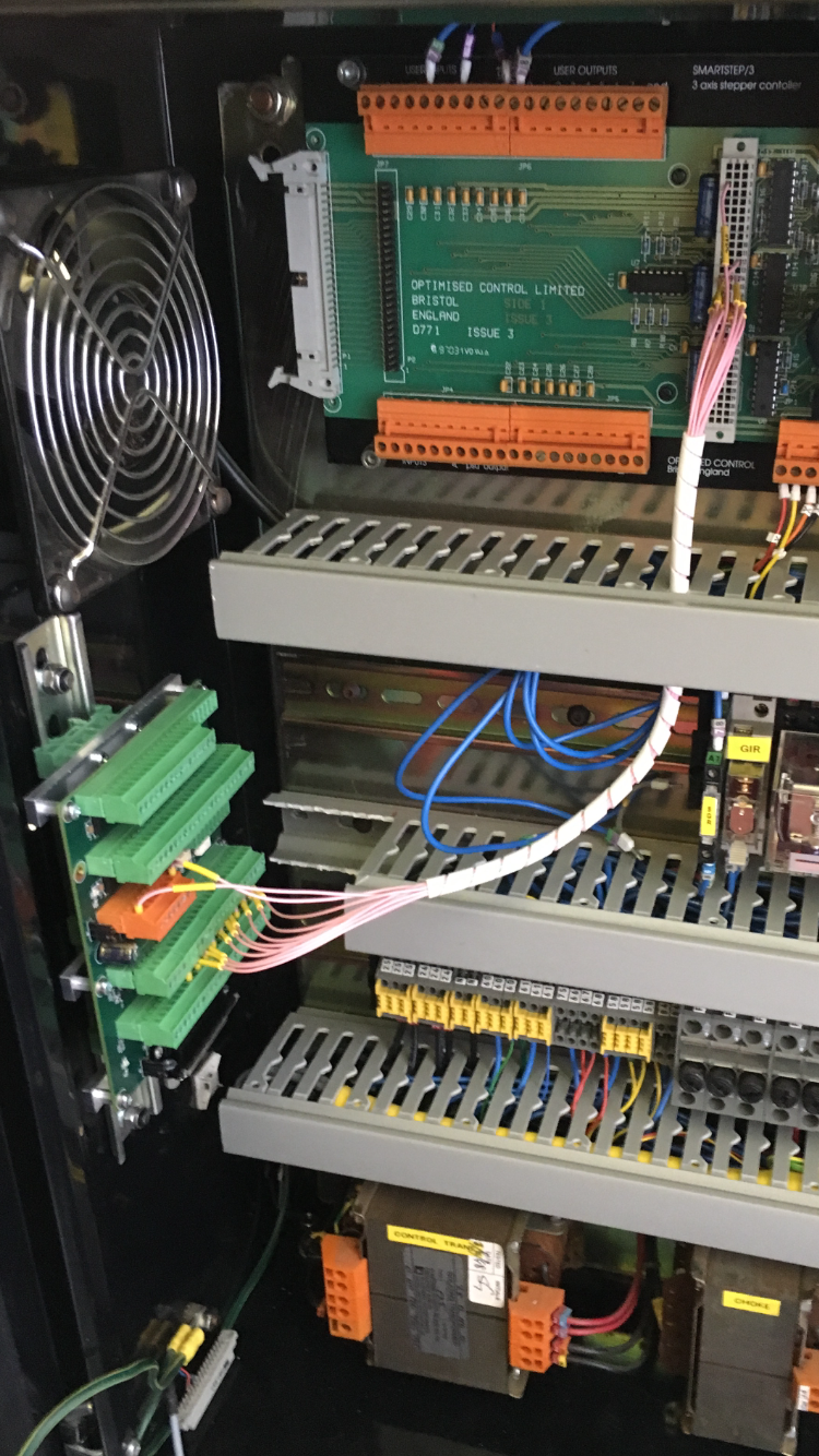

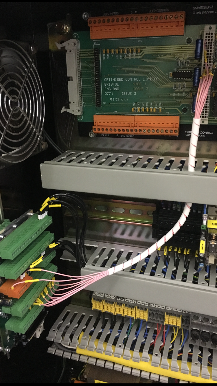

So, wiring loom fitted...
One snag, I found the 96-way plug on the Baldor had badly soldered pins so the connector wouldn't go on; some pins higher than others and some at angles. I ended up removing the board and heat sink and removing the board from the heat sink to straighten and get even pressure behind the PCB to avoid damaging the solder joints or PCB itself. Connector went on easily enough...
All hooked up, with the MESA 7i76 stepper I/O board fitted to DIN rail mounted in the position the original spindle isolator board was located. The 7i76 features and opto-isolated 10V analogue output, so no intermediary board is needed; making space and reducing complexity.
Best step is to fit some DIN rail terminals to modify the limit switches and E-stop. Then final task is the spindle 10v analogue signal cable plus the guard interlock and spindle "go" signal.

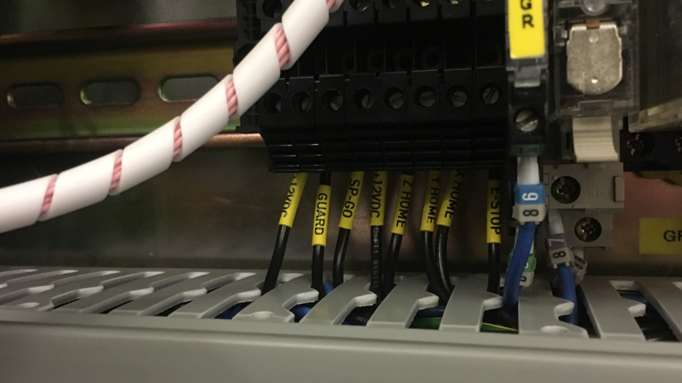

New block of terminals to terminate the home limits, e-stop and guard loops. All seems well, but this X axis limit issue is persistent.
I traced the length of the X home limit wiring and tested continuity at every stage, without any issues. It seems to only flake out when the panel is powered, indicating maybe severe noise or damage somewhere. The switch is open all the time; when powered off, continuity tests show the switch and wiring to work. Bizzare.
I've got to run a 3-core shielded cable for the analogue spindle control, and then I'm done in the "direct" conversion.
