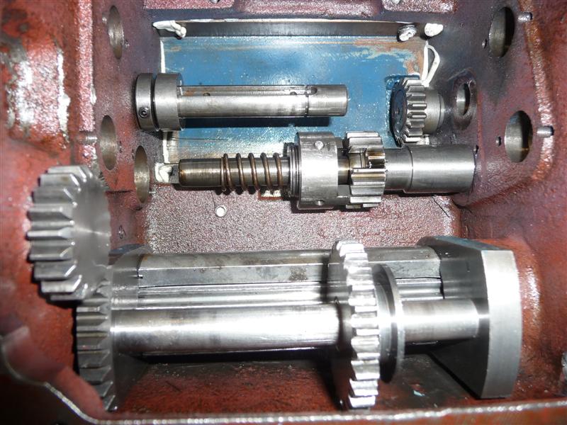

Pete Thanks but I have tried the hammer on it, but the bearing end is fairly rough with a flat spot on it's full length .
There are also signs of previous tampering of the bodging sort on the shaft end in the form of file marking UUUMMM .
Got a lathe and uses a file to try and round off ... Numpty written all over it .

Hi Pete the offer of the gears is great thankyou ... it's the 21 and 24 toothed gears on that shaft I need the 24 is worn till the tip is very narrow and the 21 has signs of bad selection meshing with half wear .. how much would you want for the gears ?? I am thinking of removing the VS pulley arrangement and just fitting a 2hp vfd motor setup. and possibly a 2 step pulley .

Ok I'm a bit confused. My stacked cluster has a good 24 but no 21 at all, the next smallest is a 20. The 24 has rounded sides to the teeth for some reason, perhaps they did it at the factory to aid engagement.
There is a good 21 in the box but it looks like a 16DP not a 14DP. I think it's from higher up in the box.
