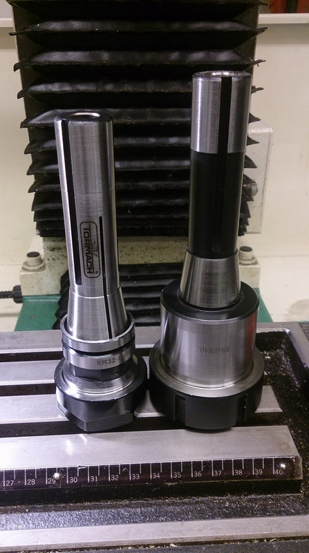

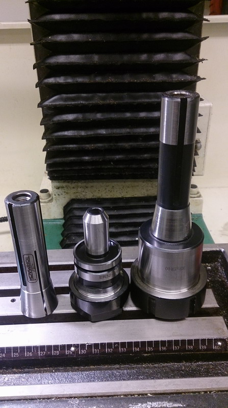

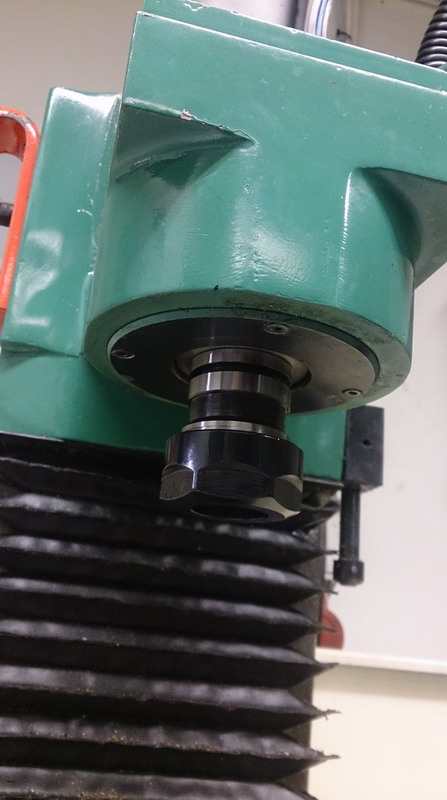

I bought a collet and a ER32 collet holder from Tormach to check it out, and it fits perfectly. It also features a small reduction in tool length. Now I just need to figure out the axial force that Tormach recommend for the drawbar, so i can start designing a quick change setup.
Here's the comparison between the R8 ER40 tool holder that came with the machine and the Tormach R8 collet and ER32 tool holder

It fitted nicely to the spindle, i just needed a new drawbar bolt as the threads were imperial.
