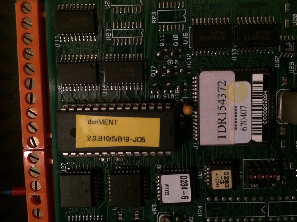

You may find it will work of XP, possibly Windows 7 but that depended on the software on the eprom on the main board (large chip with a sticky label on the middle with a version number on it and possibly other data, looks to be a yellow label in the photo) and the control program you have.
If you can post up what info is on the label someone should be able to give you a better answer than that.

I popped the back off the mill today and took a picture of the label you had mentioned. It appears to have " denMENT 2.0.B10/S/B19-JD5" printed on it
