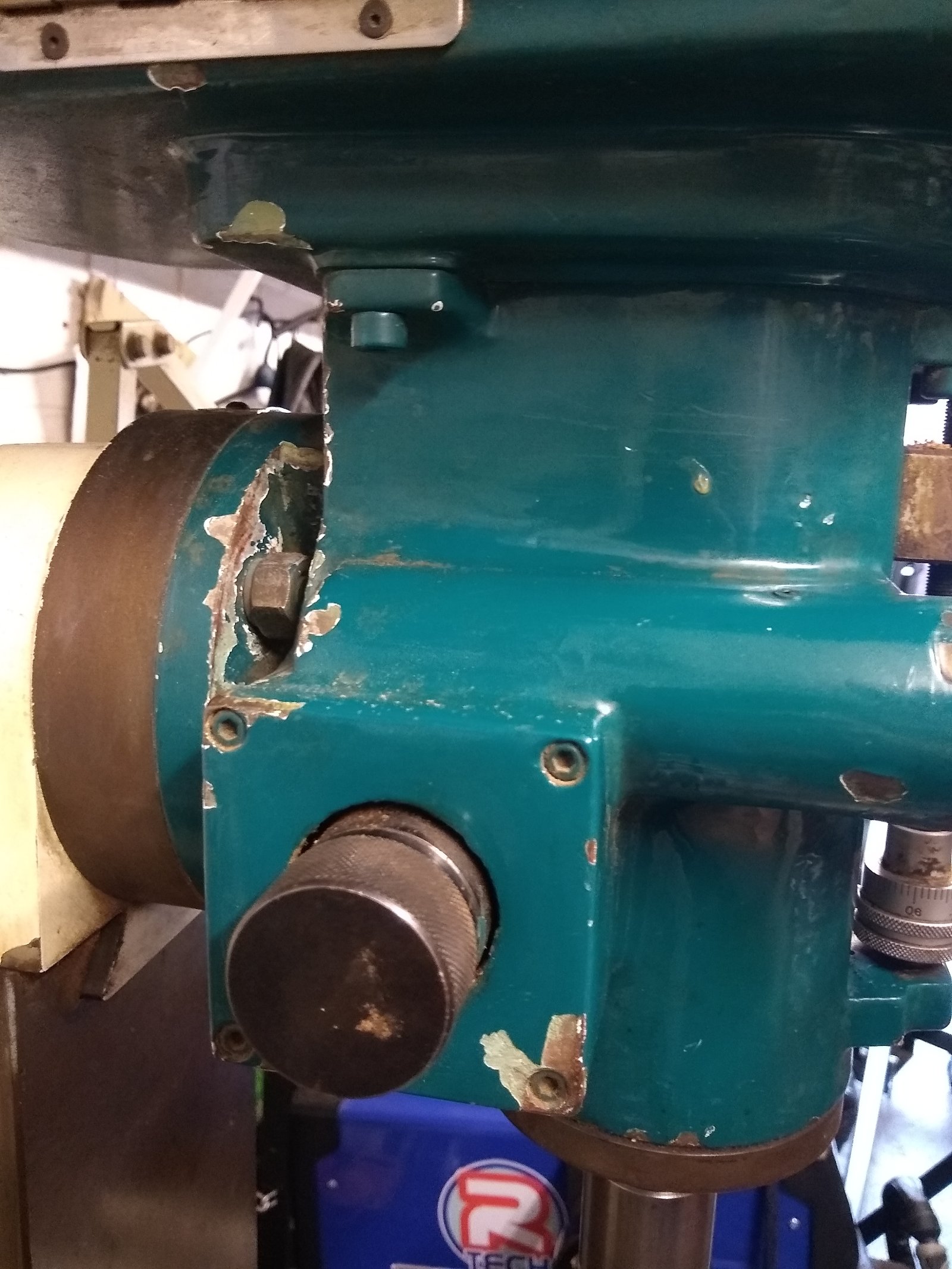

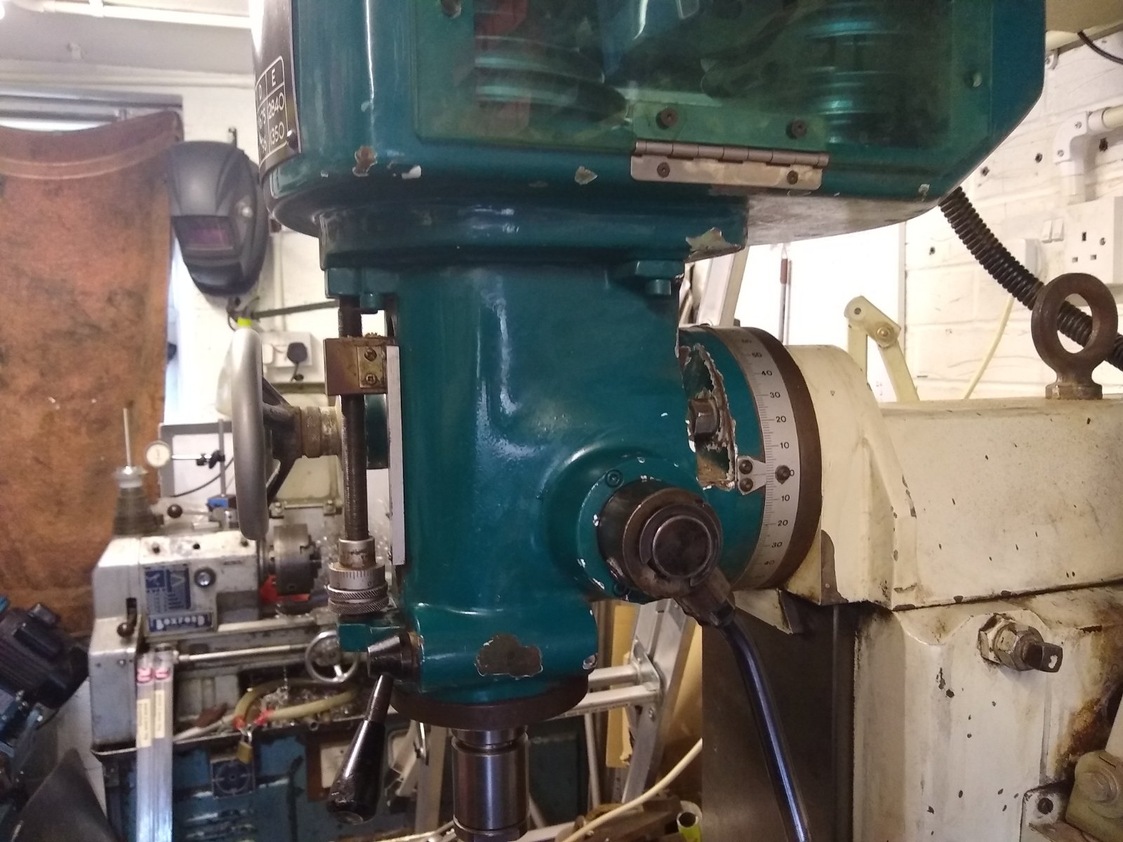

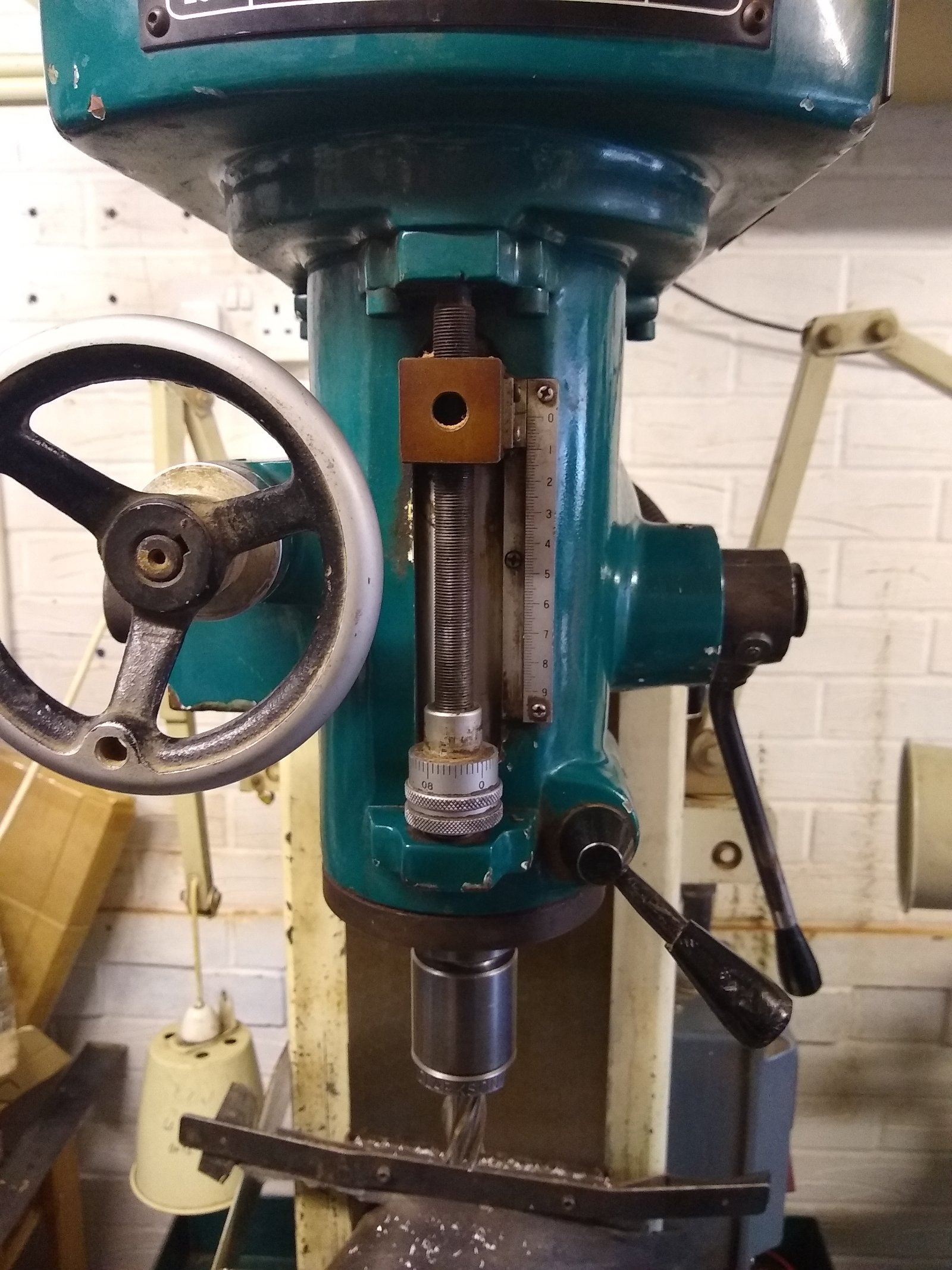

by Rgvbaz

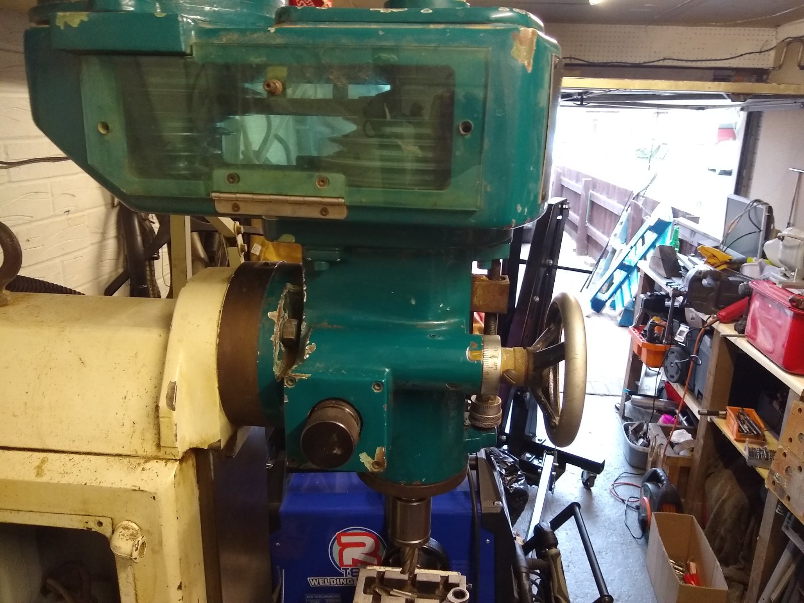

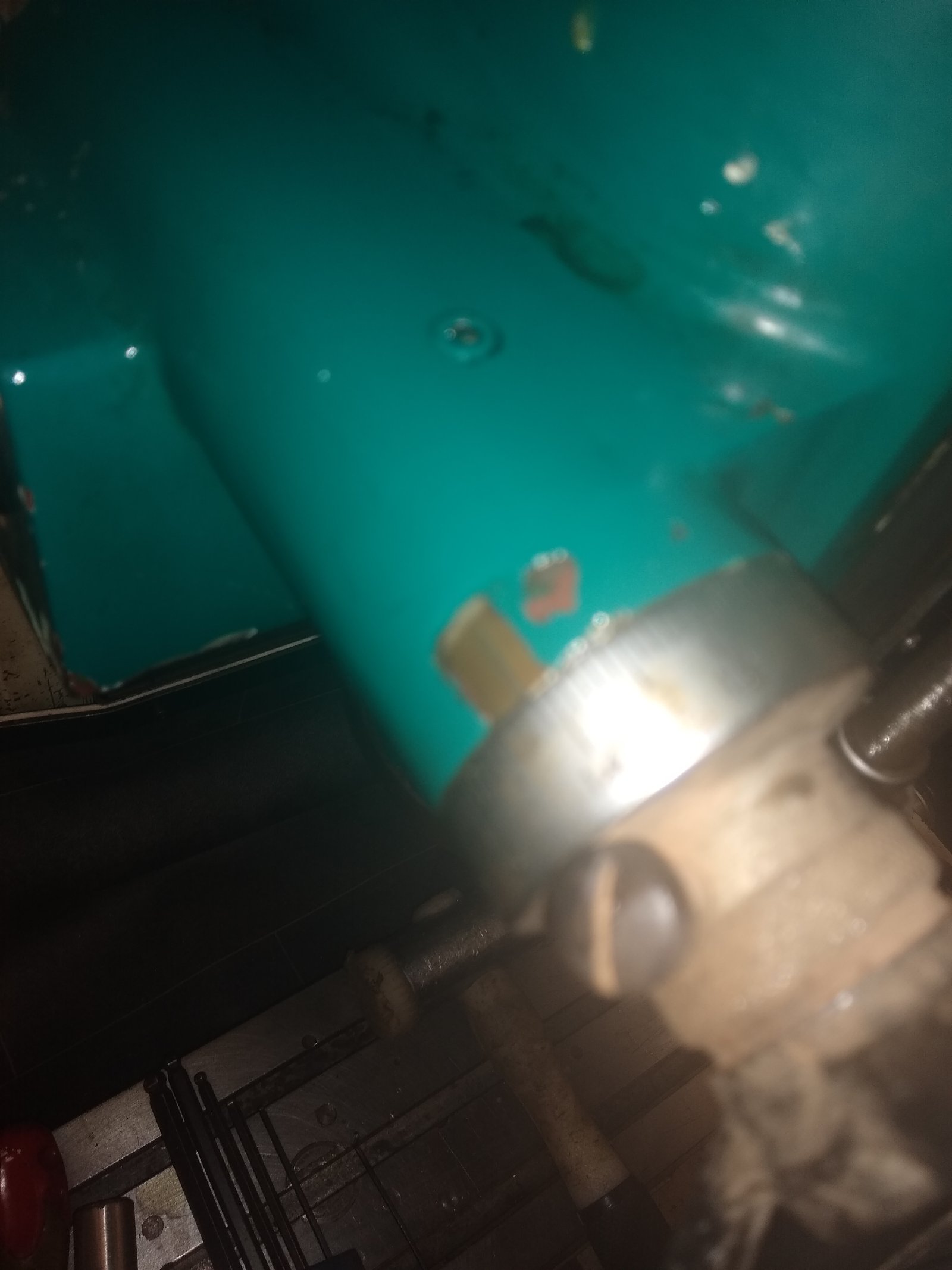

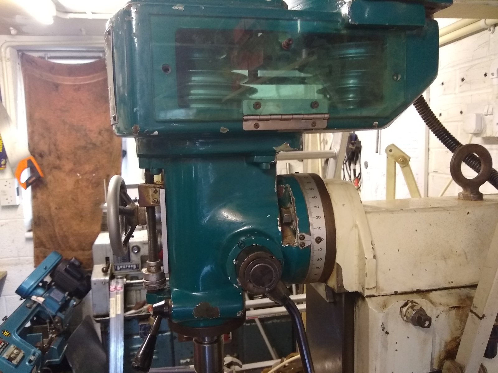

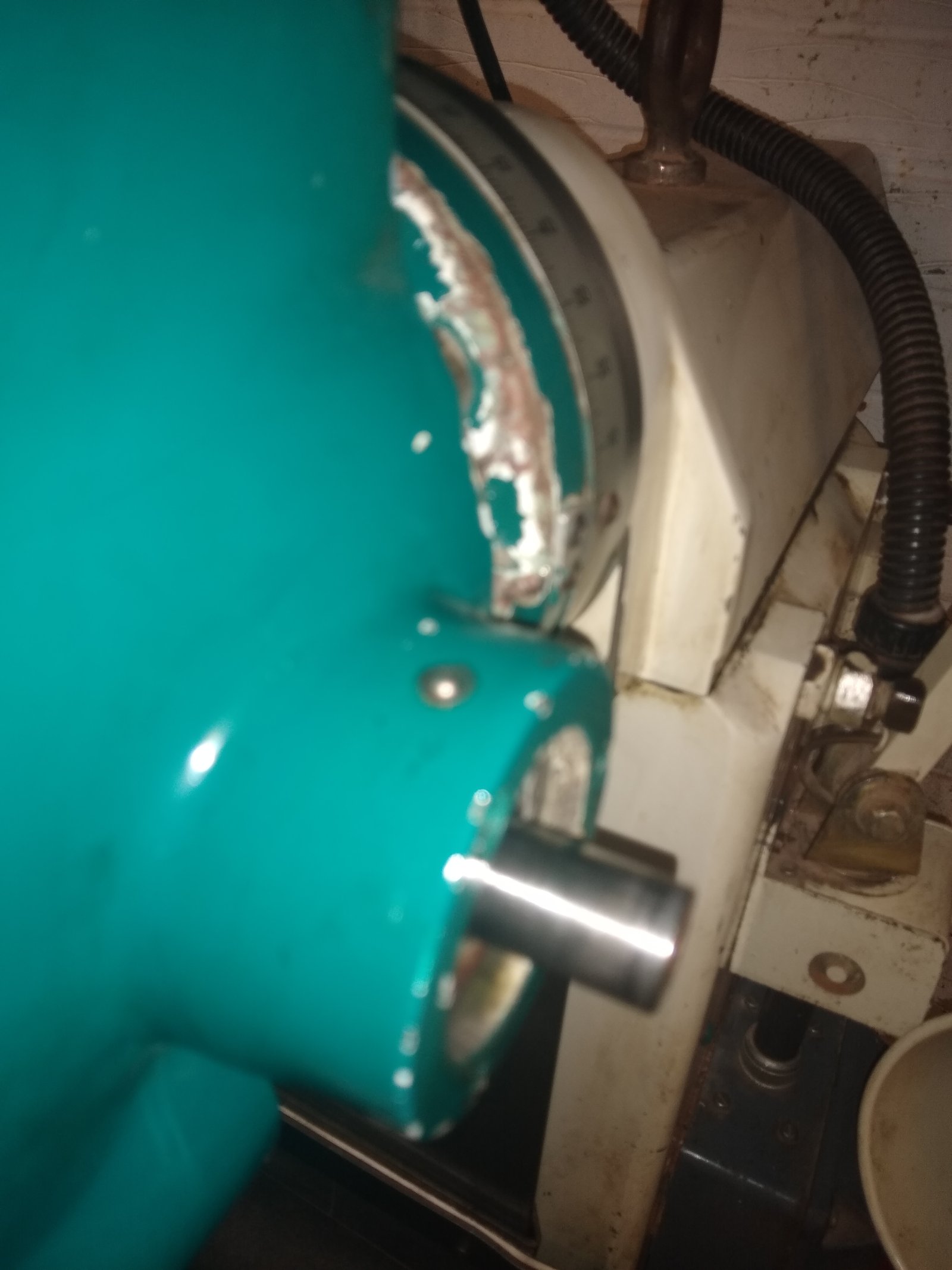

Andy B wrote: Mon 20 Jul , 2020 9:20 am Could you post a picture or two of the vertical head on it?
I'm interested to see if it is the original TS head casting, the later 'import' style, or something else.
Thanks,
Sorry after some more looking around it looks like this could be different to a TS head casting. I've attached a couple of pics.
Re: senior mill with R8 spindle
Posted: Thu 23 Jul , 2020 15:41 pm
by Andy B
Thanks for the pictures - they align with pictures I've seen elsewhere (e.g. on the Model Engineer forum), and having looked again at the cross-section drawing in the late issue manual it makes sense as below:
On the original Tom Senior quill head (known as an 'S' type or 'E' type), the vertical fine feed hand-wheel is on the right on the lever feed on the left. This would only take a MT2 spindle.
The later Denford Senior quill head (also confusingly referred to as the 'S' type head) was, as far as we can make out, an import. The vertical fine feed hand-wheel is on the left and the lever feed on the right. It had an appreciably wider quill, so could accommodate the bigger R8 taper.
The bearing arrangement is also quite different, having ball bearings for the pulley shaft instead of the plain bronze bearings used originally.

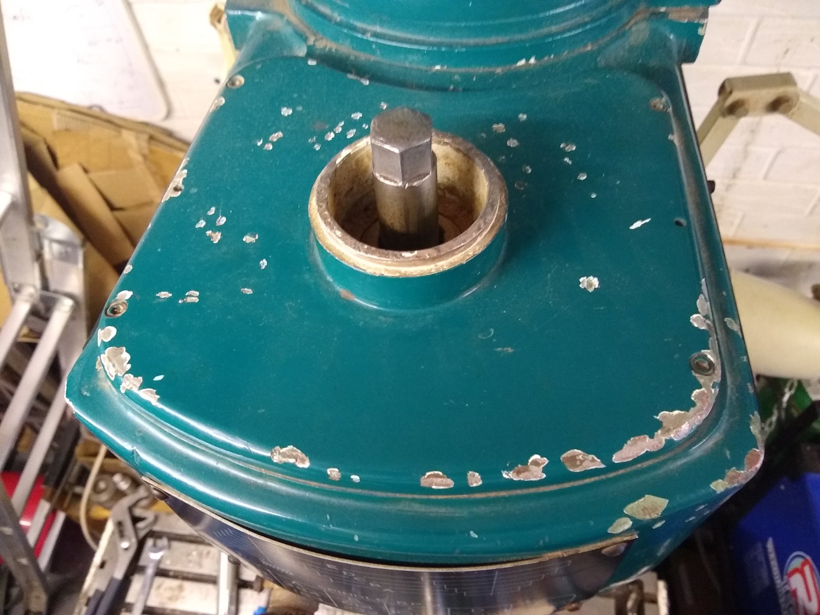

Posted: Sat 25 Jul , 2020 12:57 pm
by Rgvbaz
Thanks again for the info Andy.

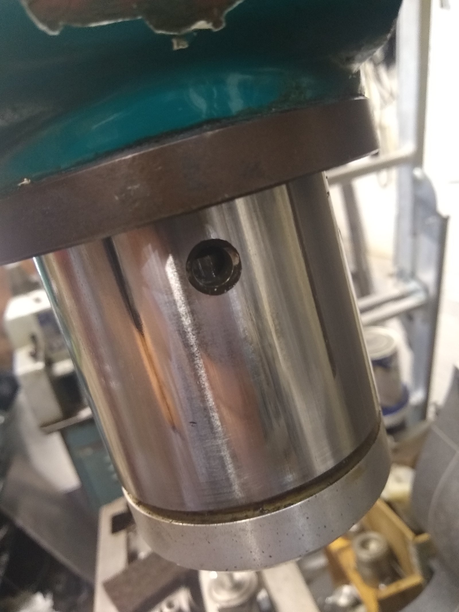

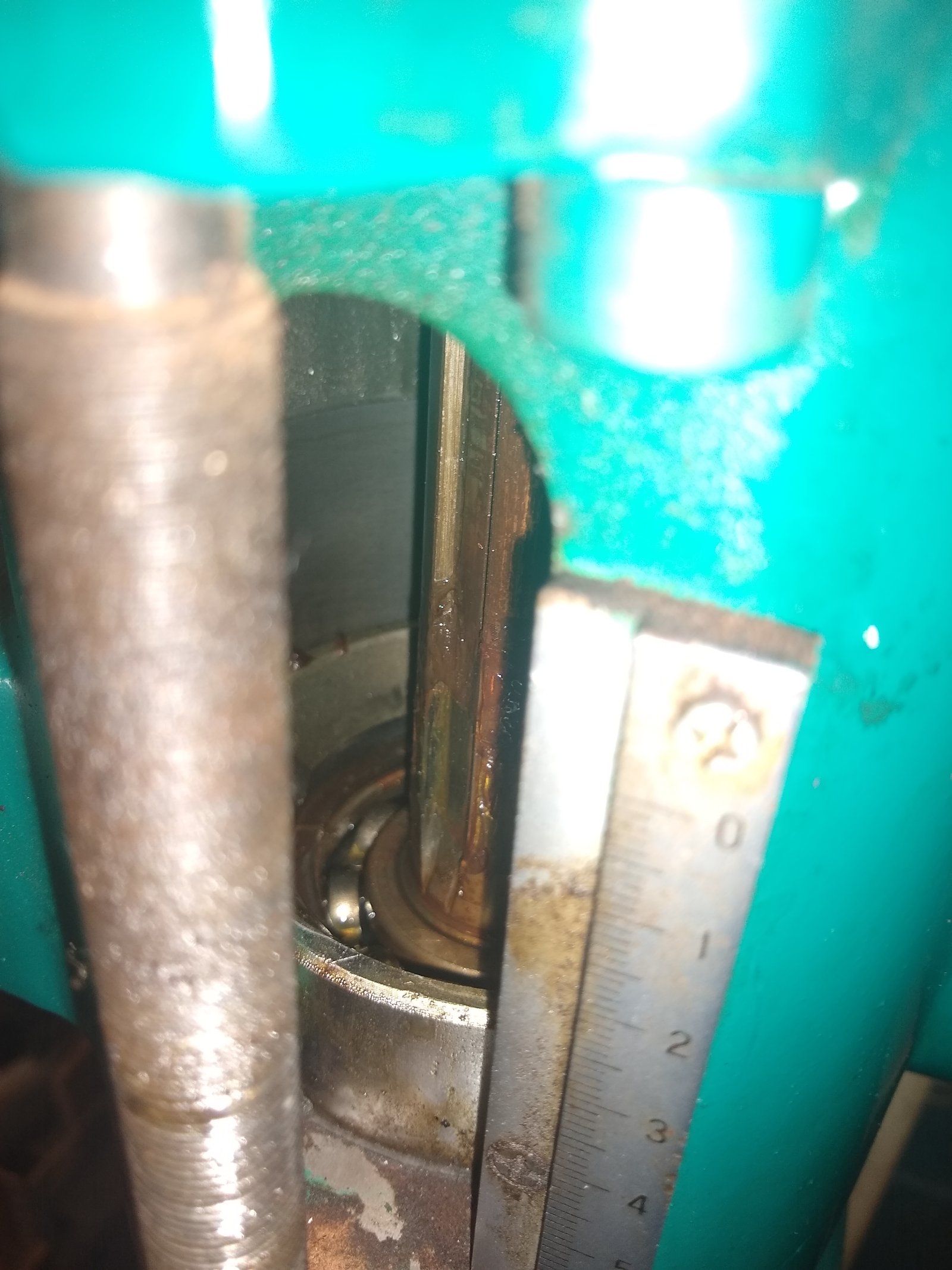

I had a look at TiP manual. It seems to be the same head. I had a look inside the pulley case and there is metal in the casting that looks like it could be drilled for the oil cup and oil ways?
I found a coupe of springwell oil points on the head but are for the quill lever and the fine feed handle. Maybe these also lube the spindle?
I had a peer into the spindle through the front and the bearings don't appear to be sealed and packed with grease so I gave it a squirt of oil. There is a hole in the side of the quill too - would this be for oil? I took the ally bearing cap of the bottom of the spindle and the bearings in there appear to have some grease in them.
