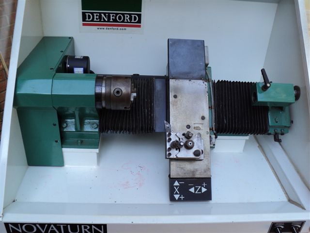

I only have the lathe, no control box. I am building this from scratch.
Novaturn
Novaturn

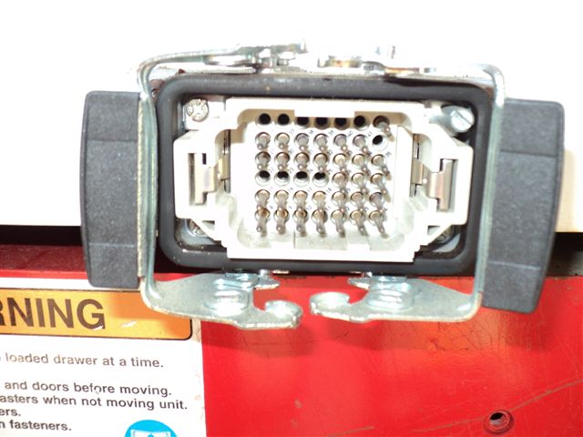

Also, who makes the interface connector ?

by Denford Admin
Isn't it a Harting ?
https://www.harting.co.uk/

I believe that I have located the correct 42 pin connector from the link above, thanks.
