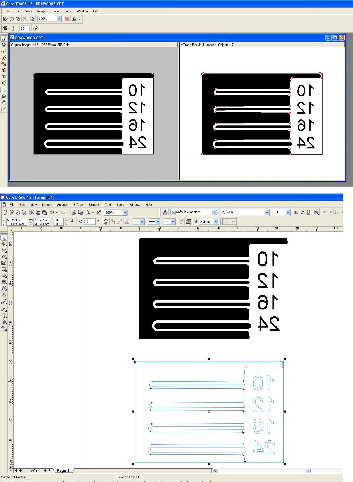

Just use Coreldraw and Coreltrace like this.
I just removed the fill from the resulting trace in coreldraw, and set the line color to blue, and it's line thickness to 0
You have to make sure the colour is 100% red (ie, 255 Red;0 Green;0 Blue) or 100% blue for the standard VLS driver to reconise whether you are vector marking or vector cutting. This may not apply to your machine or driver combination - all it did on certain drivers was to adjust power and speed of the laser to allow for vector cutting (red) or vector marking (blue) or raster engraving (black or grey)
