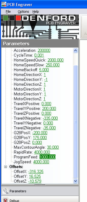

Because the PCB engraver was designed to be a simple control system, it has a fixed feedrate. Obviously you can alter the feed override to slow things down, but if you are doing much the same kind of jobs, and always need to reduce the feed, then you can change the default in parameters:
Goto menu Options > Setup Parameters enter
denny as the password.
- pcb-engraver1.jpg (19.68 KiB) Viewed 28509 times
Click on Parameters and change the value for programfeed from 1000mm/min to something that works for you...
- pcb-engraver2.jpg (72.43 KiB) Viewed 28509 times
