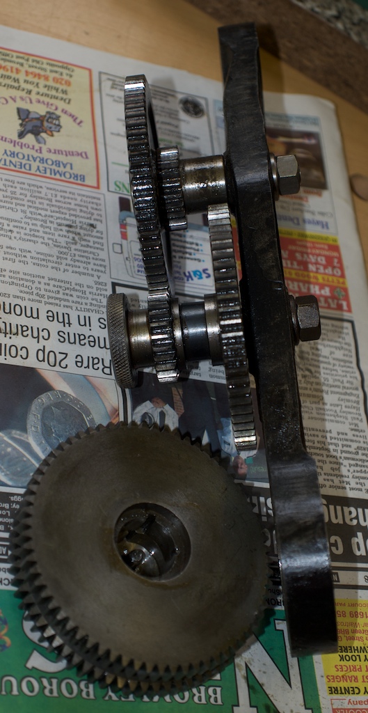

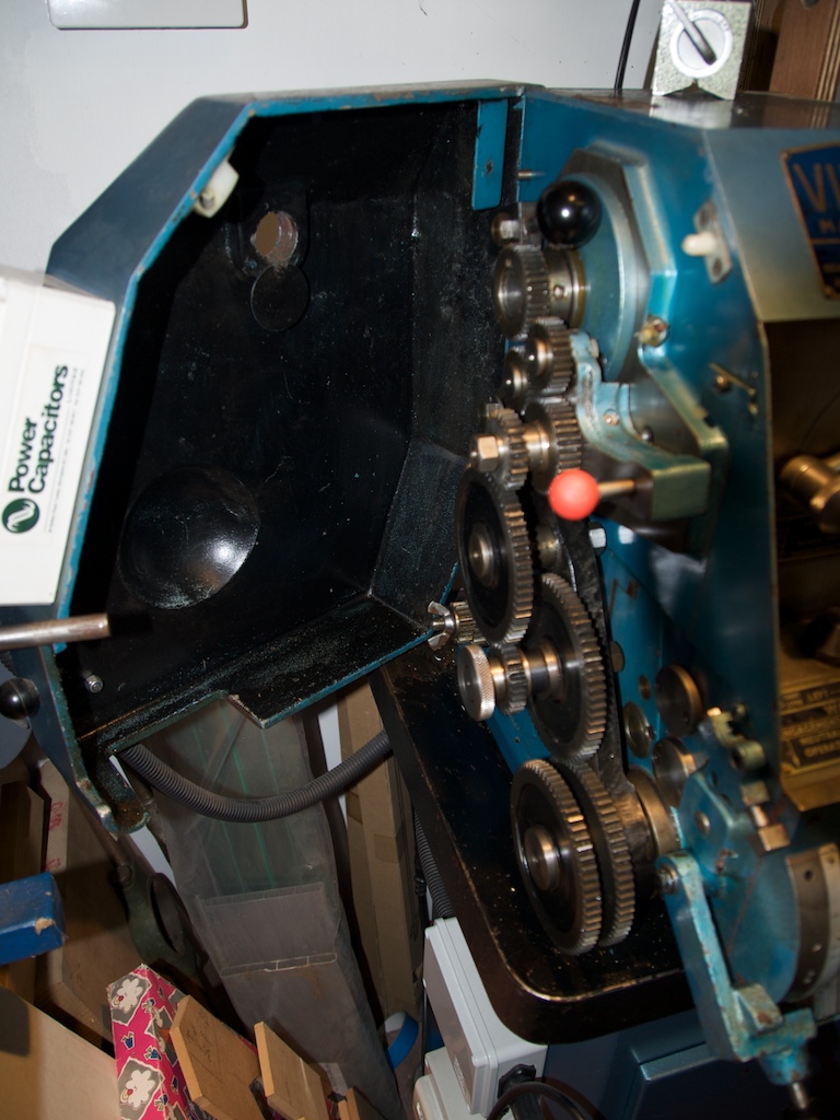

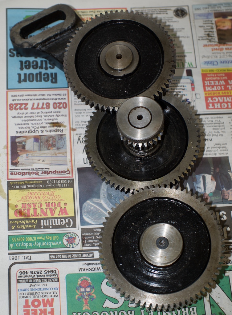

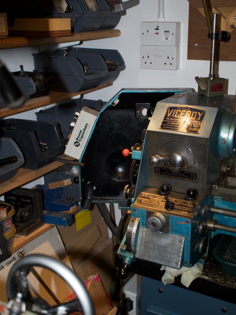

Here are some pictures. From the first you will see that my workspace is small, and full-frontal gearnography is not possible with the gear train in place on the machine. So the second is a general view of it in place and the others of the quadrant and gears off the machine.
As I think is standard, the gears are:
Stud
Compound 64 / 22
Compound 24 / 66
66
In the last three photos, of course, the stud gear is not there but still back on the machine.
Sadly, although all four larger gears are stamped with their teeth ("64", "66") there are no ML... numbers.

I was wrong, and assumed incorrectly!
Apologies for any confusion caused.
Your pictures prompted me to look closer into some of the files that Admin sent me recently, and there I found drawing ML115-903 which shows a quadrant like yours. The pitch between final idler and gearbox shaft is shown as 4.125", which is right for a 66t gear pair at 16DP.
The geartrain schematic (ML115-900B) states that the end drive gears are 16DP also.
These dimensions tie up with the pitch on the quadrant for the 280 lathes - I had never actually measured my gears but will certainly do so this evening (edit note - I checked and they are 16DP). I had only ever looked for the drawings for the conversion gears for my lathe, which are all shown as 18DP. So I assumed (incorrectly, as it turns out :oops: ) that standard and conversion gears were the same pitch.
The drawings for a non-gearbox lathe are definitely 18DP for all versions.
So it does now appear that:
'Standard' end drive gears for gearbox lathes are 16 DP
'Conversion' gears for gearbox machines and all idler / drive gears for non-gearbox lathes are 18DP
Tumbler reverse gears are 20DP.
I'll add this info into the thread on conversion gears.
