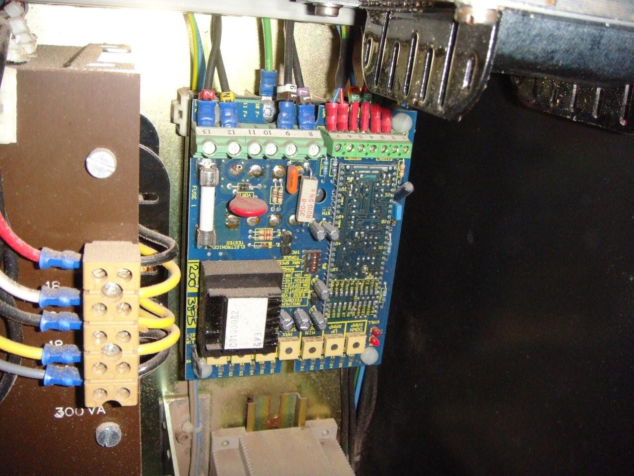

I recently bought a Triac PC (modified for USB and VR Milling CNC) from Ebay, my first ever CNC mill that I bought to learn a bit about. I have only had it a couple of days and it has seemingly broke. To be fair it is an old machine the guy selling it did say he noticed the spindle speed vary a little last time he used it but not much.
Tonight I have come to use it and I have very very slow spindle speed, putting VR Mill into Jog (no program) and starting the motor gives me no more than around 250 rpm at a guess, I crank up the spindle speed dial until show 4000 on screen and the motor barely increases to around 300 rpm maybe. I have put my test meter on the motor input terminals and varying the speed in VR mill from 250 to 4000 which produces a varying voltage at the motor between 17v and 20v DC.... I'm no expert at DC servo motors but that does not seem enough for what I believe is a 140v motor.

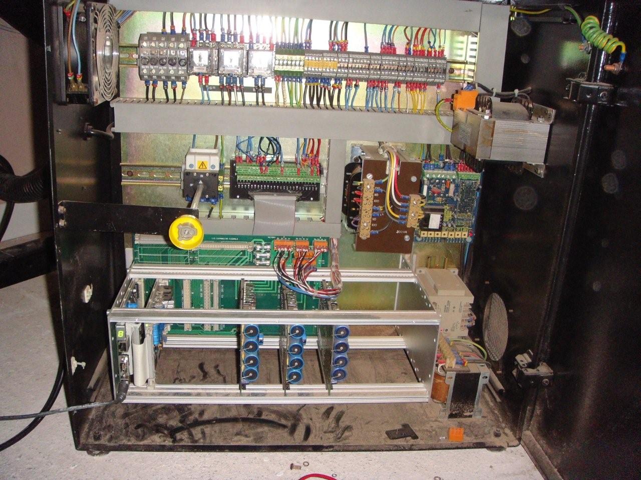

I have attached some photos of the controller hoping someone here can help me before my wife finds out I blew £2k on something broken
I'm safe with a test meter if someone can point me where to look

Visit the link below and download the Triac Diagrams.
They may not be identical to yours but the spindle works in exactly the same way.
download/file.php?id=701
The sheet you need to see is SD17.pdf, this shows the spindle drive.
Terminals 2 and 3 have an analog input of 0 - 10V DC 10v giving full speed, 5V half speed etc.
Pins 4 & 5 are the enable link (interlocking the spindle go relay and guard. This circuit must be OK for the spindle to run at all.
Pins 12 and 13 are the AC mains in and you should have 240V AC on these all the time.
Pins 8 and 9 are the motor output and you should see a DC Voltage up the the motor maximum on here (not sure what it will be but 140VDC sounds right)
The +ve terminal goes to the choke then the motor.
Check the Analog in first. try and start the spindle and run it to full speed. (you should have between 8 and 10VDC)
If you have this check the mains input then the DC motor out.
It is possible there is a bad connection from the electrical box to the machine check this as well!
Good Luck! Let me know how you get on

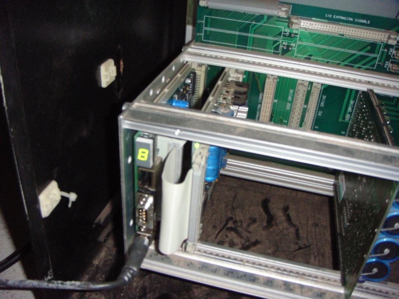

Is the analogue control card the one next to the Baldor card connected by a large ribbon?....i.e 2nd from the left on the rack in my picture?
Oh just one other thing my Sprint card has a label saying it's a 1200, is it still the same manual?
Paul
Re: Triac PC Has it died?
Posted: Fri 03 Jul , 2009 9:24 am
by Denford Admin
- Yes

Just to let you know I spoke to Sprint, really helpful guy (Jim) suggested I check between 1 & 4 for 10v, there wasn't anything (about -.3v) so we have concluded the spindle drive is indeed faulty. I have ordered a replacement (nice to know they still make them!) for delivery tomorrow.....along with a 10k pot to get me going manually.

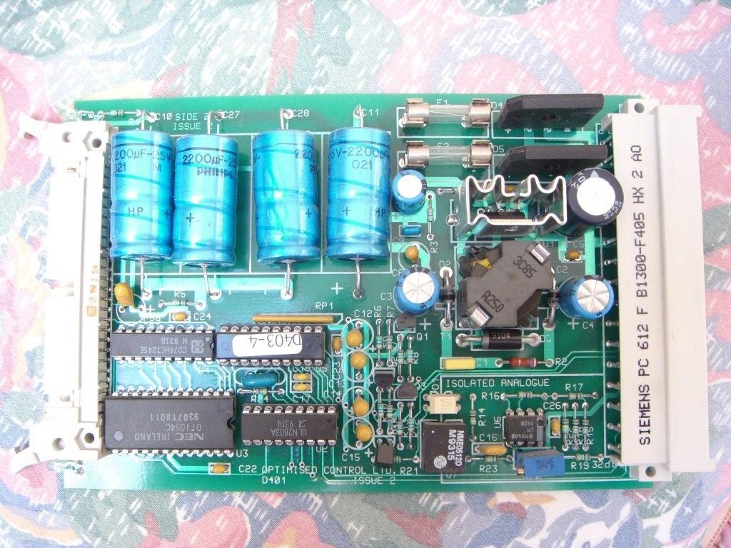

The analog circuit is on the card next to the one with the 7 seg display Linked by the ribbon.

Here is a picture of the card, it may help identification.

I fitted the new sprint board copying the dip switch and pot settings from the original and away it went.
After a satisfying myself it was all fine I decided to take off my 10k pot and try the analogue connection again.... as soon as I went to start the motor it took out the RCD in the house!.... which I have to say surprised me some what ...anyway I wasn't prepared to try that again so I went back to the pot and all is well.
I'm thinking that maybe the the analogue failed first and took out my sprint with it.

On the card photo you can see in the bottom right a section screened as Isolated Analog.
The spindle drive unit is not isolated. The Analog input floates at 240V. The control card should provide 0-10V that is isolated from earth.
It sounds like the card has failed which has resulted in the mains voltage shorting through this circuit and being connected to ground.
I would just try and trace the red and blue wires from the rack to the drive and check they are not trapped somewhere or shorting to ground. If it is a screened cable check the screen is not touching one of the cores.
