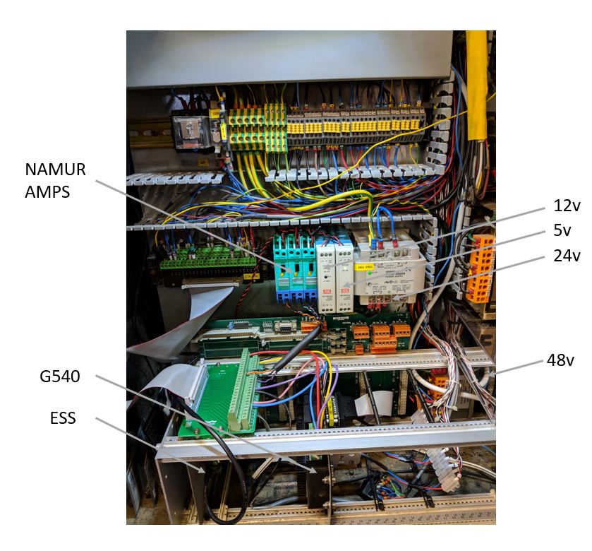

Hey Rob,
Thanks you for such a comprehensive reply. I have a dual core shielded cable ready to try. I will try it ungrounded first and if that makes no difference I will ground it to the 48v power supply that the steppers use.
The other thing that I could try is connecting the ground of the other supplies. I have 5v, 12v and 48v supplies that I have added plus the 24v supply that was already in the cabinet.
This is how it looks at the moment:
