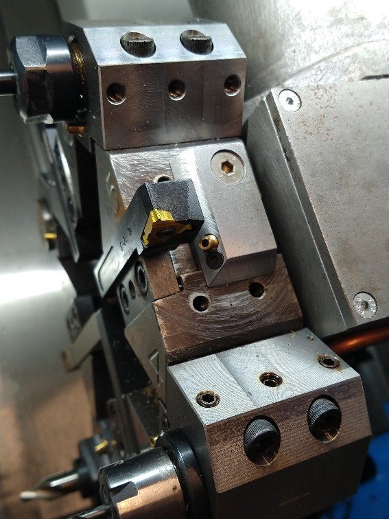

Not posted for a while so here are some pictures of the new tool holders and the through coolant modification I decided to add, all the parts have been made on my Triac and the TU150. I also modified the 3 original tool blocks that came with the machine.

Posted: Mon 27 Apr , 2020 7:24 am
by jamesgates1000
Great work on the through coolant system, could you please post some photos/details of where the coolant feeds into the rear of the turret?

Posted: Mon 25 Jan , 2021 0:22 am
by rasp
Here is a picture of the external tool coolant nozzle.
The only issue I had was it firing coolant down the spindle bore so I have a plastic bung in the back end now.
The lathe is working great and I am happy with how its turned out.
