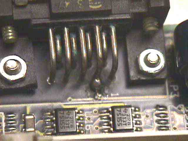

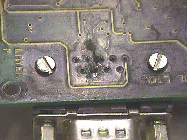

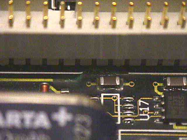

FOLLOWING THE ABOVE SUGGESTIONS, IVE CHECKED THE CONTROL
CARD & FOUND CORROSION ON SEVERAL PARTS OF THE BOARD, IN
FACT PART OF SOME OF THE ETCHING IS ERRODED AWAY,

Post by Denford Admin » Tue 16 Jan , 2007 23:30 pm

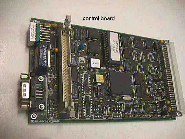

Is it a Baldor control card (the one with a red seven segment display at the top of the card rack ?)
We may have some spares, or it may be possible to get Baldor to repair it / exchange it.
Depending upon the cost of that, it may be a better long-term option to update the control card and software to USB and windows (new PC)control software - we have done a few Triacs which I reckon to be the same vintage as yours

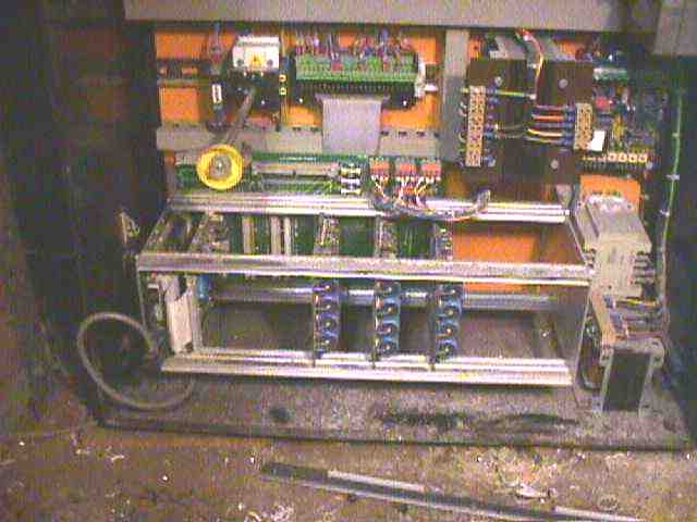

To be sure what we are talking about, can you attach a photo of inside the electrical box, and of the corrosion you have seen ?

Post by P.J.SAILS » Wed 17 Jan , 2007 21:50 pm
I VE attached some photos of the triac , the offending board & the
damage to the baord . to help identify it .

sorry Ive got the photos in the wrong order , but i think
it will help.
corrosion on board
