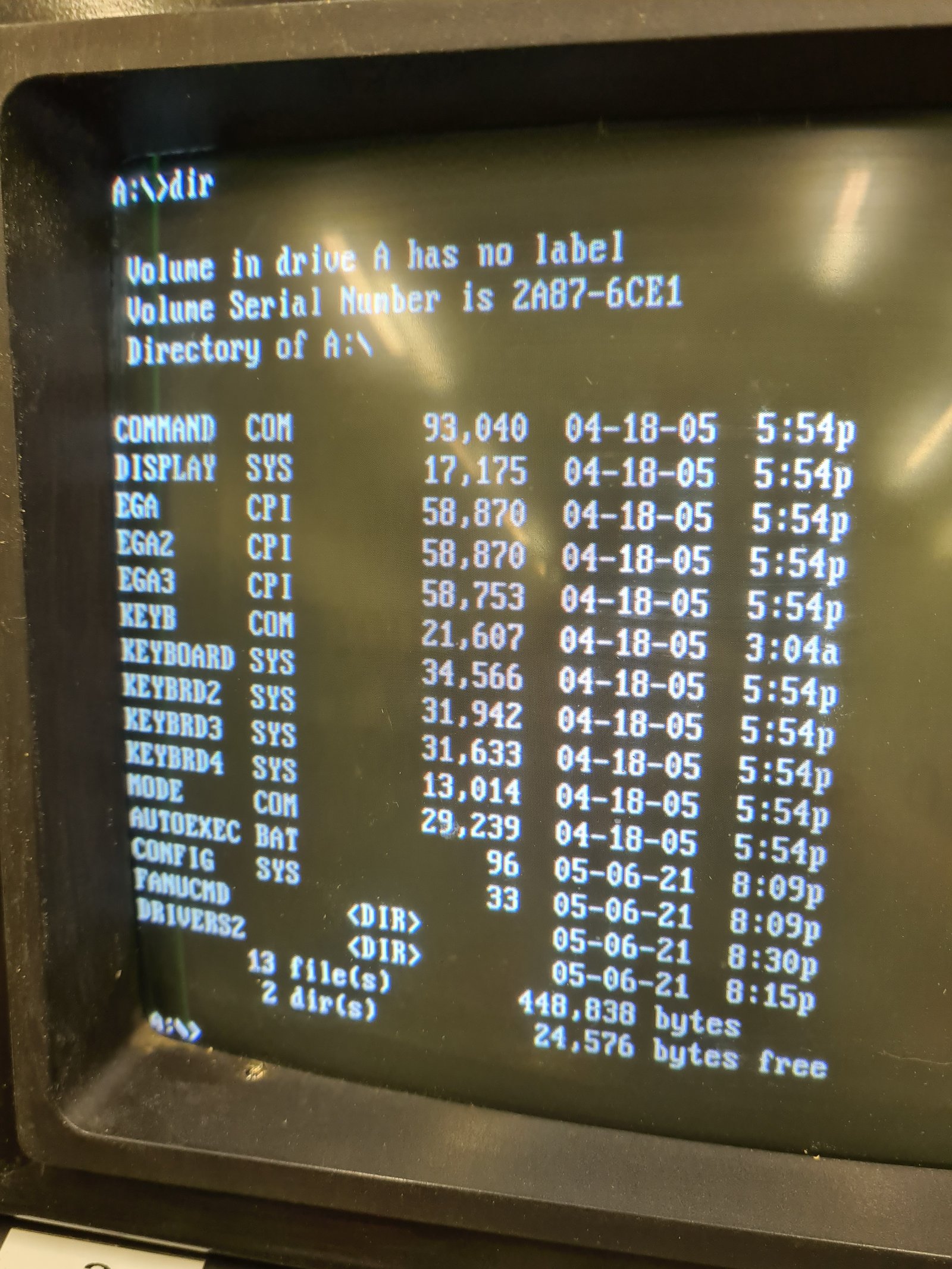

the machine came without boot up disk and so i have made a floppy that containes: Dos, fanucmd.zip and Driers.zip / Drivers2.zip from denford site.

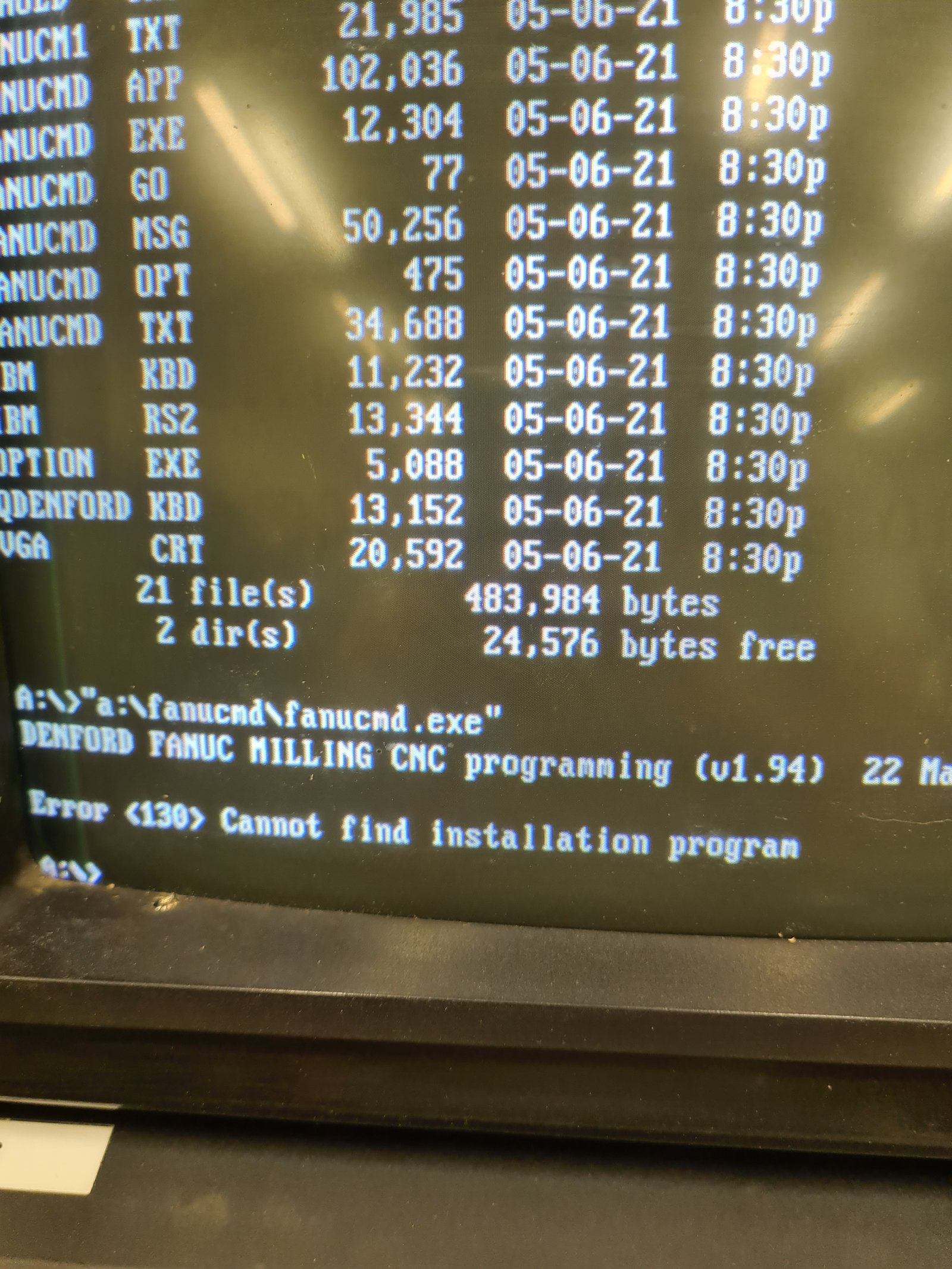

when booting I get the following error message: error 130 Cant find installation program.
Can somebody explain what im doing wrong?
attaching some Photos. Tell me if you need any more info/pictures.
/Robert.
Re: Triac VMC, help needed.
It looks like you have 3 different directory's for the software All the files should be in the same one.
