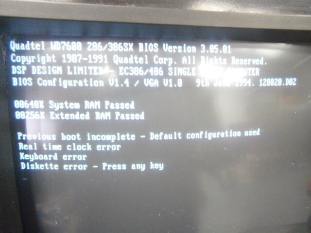

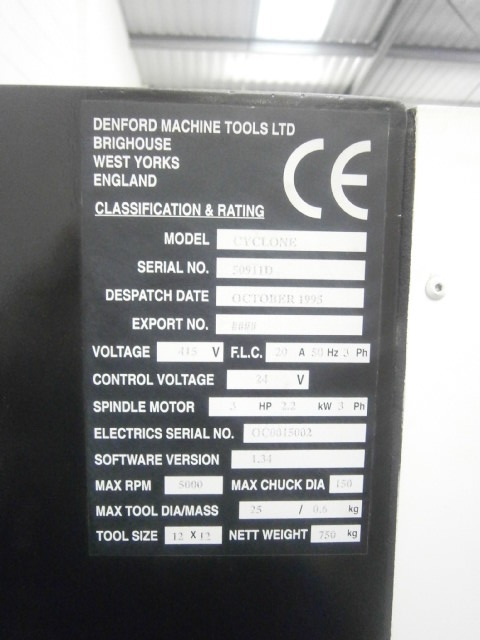

I have a 1995 tu150u cyclone in what would appear to be A1 condition. I finally managed to power it up recently, but I got some messages up on the screen. I have the machine. No software, no manuals. What do I need to get going? The 1st image is the message I am getting on the screen and the second, the spec of the machine. Can you advise what I need. It has the original tutor software.

The TU15U requires a 3. 1/2" system disc in the floppy drive on the side of the electrical box. It would be easier if you can locate the original floppy disc, otherwise you will need to create a bootable floppy & install the TU150U software which can be downloaded from the Dos software section on the Denford website.
