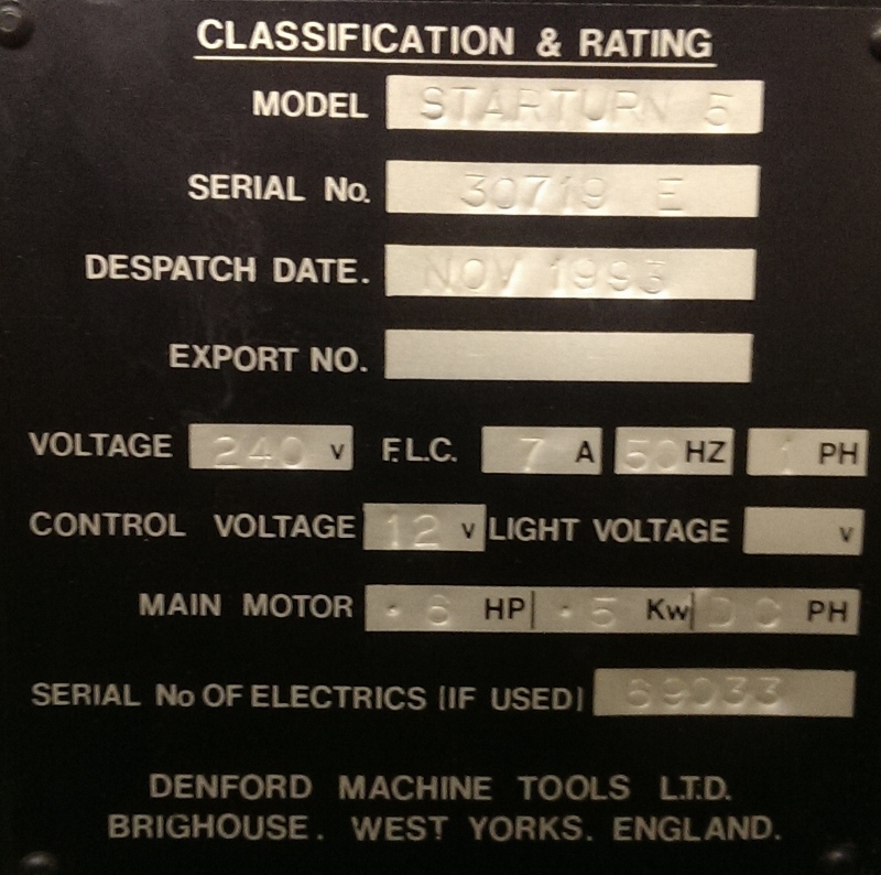

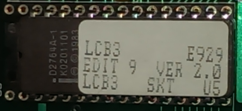

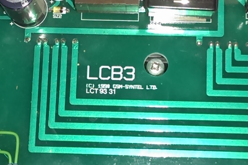

I have a Starturn 5, below are pics of the board and eprom.
