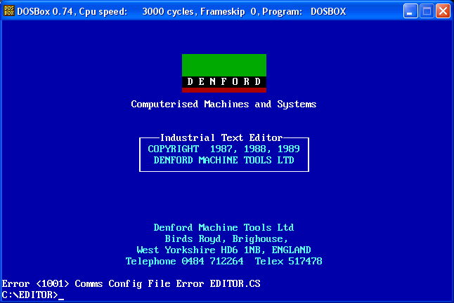

Here it is running the industrial text editor :D (I had to run from indedit.bat not editor.exe)
