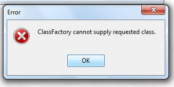

Customer has recently had this error:
ClassFactory cannot supply requested class error
If the software has not installed properly then you normally get a Class not registered error.
Previous ClassFactory errors have been fixed with a replacement Baldor top card, however, in this instance the same machine could be run from a different PC so the problem was narrowed down to something on the PC.
It was fixed by installing easyUpgrader from the VR Milling 5 CD, checking that the firmware etc. was up to date (which it was)
Then, UNinstalling and REinstalling VR Milling v5 made the error go away.

I recently resolved an issue with this alarm by first installing easy upgrader of the VR CD.
Then when you run and Click Check my machine it found the baldor card correctly and said all was up to date. (if not then upgrade to the current firmware).
Then using the control panel add and remove programs: Uninstall the VR Milling. Then reinstall from the current CD hopefully this will resolve the issues.
