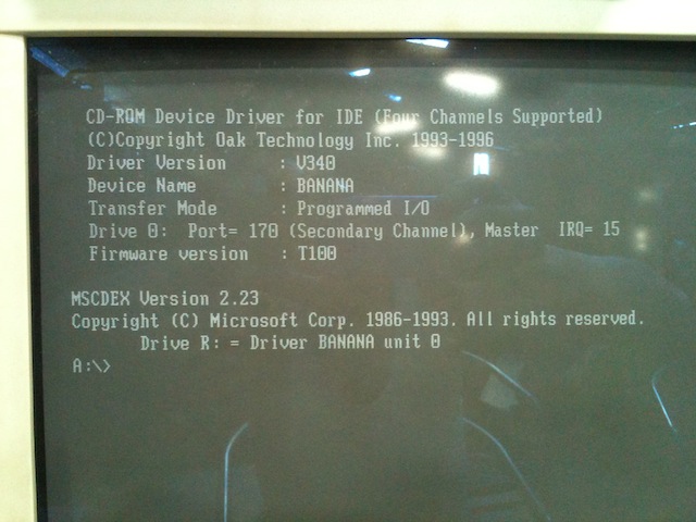

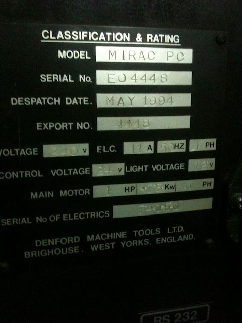

Long story short, I have a MiracPC and no windows based software to operate it.
I searched for answer and I think a boot disk could help.
DOS Bootdisk made and working, I can go to the DOS Operating system.
Then I take out the DOS Bootdisk and insert a "SELF MADE" Mirac Bookdisk"
I'm attaching the pictures to show my machine's plate and THE RESULT I captured from the screen.
S/N
IMG_4183 1.JPG (79.04 KiB) Viewed 11593 times

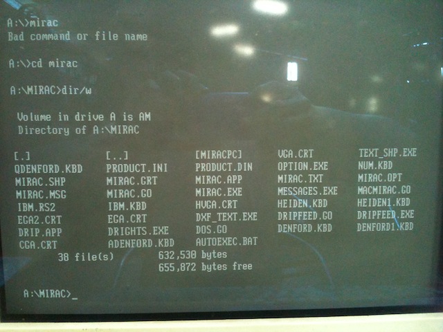

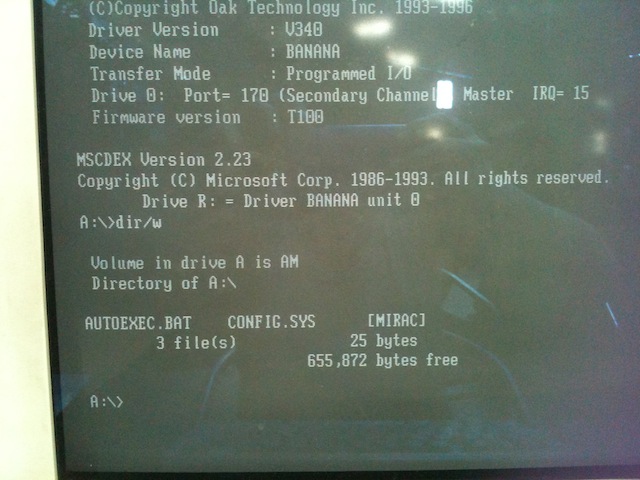

After BootDisk brings me to the DOS OS, and I remove the DOS bootDisk and put in my "SELF MADE Mirac BootDisk"
Directory
Directory
Result

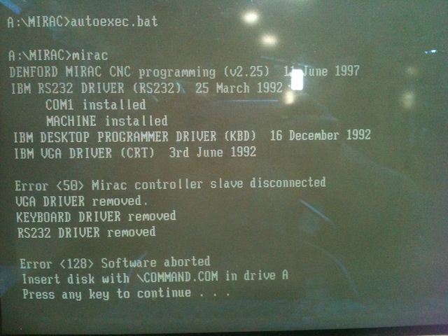

Error code <50>, <128> came out after I executed autoexec.bat from Mirac directory.

Have you got the machine hooked up to the RS232 com: port 3 ?
This post may help with the .go settings
viewtopic.php?t=58

Denford Admin wrote:Have you got the machine hooked up to the RS232 com: port 3 ?
viewtopic.php?t=58
Welcome, I should have thought of that. Resize done.
But no, I'm using com1 for the Mirac, and com2 for the Triac.
I tried Fanucl today, program starts and I can write a program, however, no luck to send that to Mirac.
I'm curious about the Fanucl could control my MIrac or not, as I saw it said offline program.
I have a strange feeling that may be Fanucl just can't make my MIrac move at all.
Anyone could tell me if I'm using the correct program? Does it able to control the Mirac?
Or should I be looking for different DOS software like Mirac or Flstep?
Re: Problem to run Mirac.exe from a 3.5" Floopy Disk, MiracP
Post by Denford Admin » Tue 14 Aug , 2012 13:51 pm
According to this viewtopic.php?t=738
You should be using Mirac software - according to an inpection sheet for a December 1994 it had a GSM controller.
This was the .opt and .go file for that machine: note that $3F8 4 MACHINE would put the machine connection on COM1: so you might want to remove the $3F8 4 COM1 entry

Thanks, Admin.
Your .Go and .Opt sample and post inspire me to do the modification.
Please find the following:
Machine connected to COM1 plus using QWERTY keyboards.
.GO
IBM.RS2 2
$3F8 4 COM1
$3F8 4 MACHINE
QDENFORD.KBD 1
18.2 0
VGA.CRT 0
MIRAC.APP
[Please find that QDENFORD.KBD 1 should be working with 18.2 0, instead of 18.2 $2F8 3]
.MACMIRAC
IBM.RS2 2
$3F8 4 COM1
QDENFORD.KBD 1
18.2 0
EGA.CRT 0
MIRAC.APP
[It should be same to the .GO file]
.OPT
IBM.RS2 2
$3F8 4 COM1
QDENFORD.KBD 1
18.2 0
EGA.CRT 0
MIRAC.APP
I can start the Denford Mirac DOS V2.25 after put the above three file into same directory.
