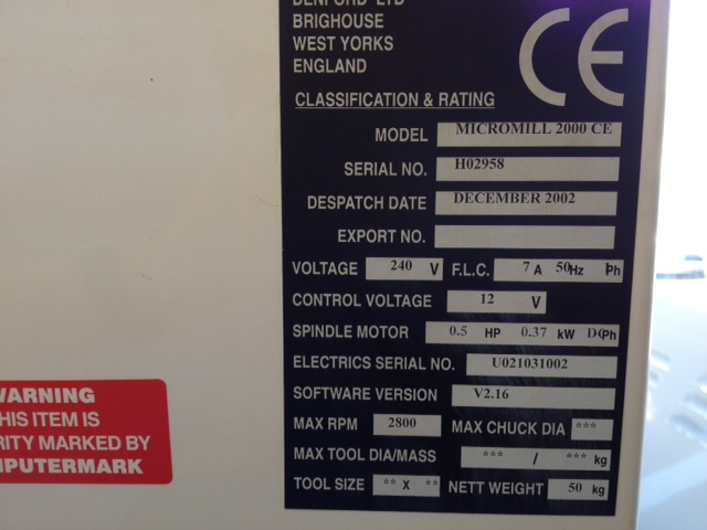

The attached photo should show most of the mills specs, and the main board of the machine is a Denstep, according to the documents posted on line.
