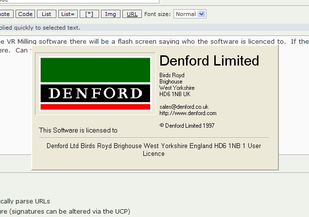

When you open the VR Milling software there will be a flash screen saying who the software is licenced to. If the licence is the version with limited lines it will probably say so here. Can you take a screen shot of your splash screen as the software is loading?
You should have a screen similar to the one attached
