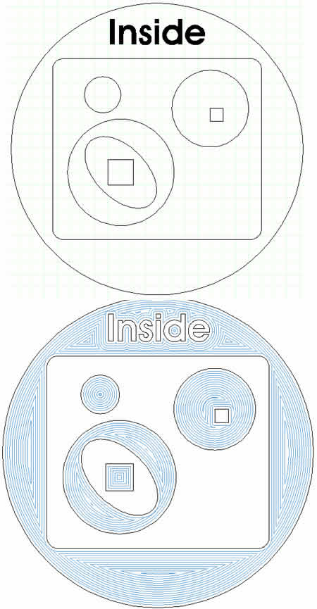

Because of the way the toolpath offseting works - it needs to create closed areas which can be used to determine whether the object is an island of another object or not. Its been designed to make life easier - you just select all your shapes, and the program will decide whether to fill the shape internally or externally automatically.QuickCAM doesn't seem to let me create open tool paths with radius comp
See example:
Simply select all the shapes in area clearance and it knows which ones to fill - very useful for text shapes
If this is a problem, you can trim the resulting area using the boolean tool, or by the secret trim command (CTRL-T)

Hi, This has just come straight from current BETA QuickCAM 2D - give it a try and let me know (max Z cut is 2mm - billet 250mmby250mm)
I could send you some pre-release files which will get your machine working if you want ?
Code: Select all
G90L
G71L
M5L
M6T1L
M3S4000L
G0X75.271Y24.161L
G0Z2.000L
G1Z-2.000FZ63L
G2X50.678Y61.484CX91.296Y61.484FX250L
G2X91.296Y102.102CX91.296Y61.484L
G2X131.914Y61.484CX91.296Y61.484L
G2X123.909Y37.272CX91.296Y61.484L
G0Z2.000L
G0X167.473Y54.190L
G1Z-2.000FZ63L
G2X156.613Y81.427CX196.199Y81.427FX250L
G2X196.199Y121.013CX196.199Y81.427L
G2X235.784Y81.427CX196.199Y81.427L
G2X196.199Y41.841CX196.199Y81.427L
G2X177.295Y46.646CX196.199Y81.427L
G1X175.932Y47.423L
G0Z2.000L
G0X140.404Y97.330L
G1Z-2.000FZ63L
G1X138.754Y98.981FX250L
G3X95.264Y116.524CX95.264Y53.845L
G3X38.897Y81.258CX95.264Y53.845L
G0Z2.000L
G0X24.780Y128.257L
G1Z-2.000FZ63L
G3X30.000Y127.639CX30.000Y150.000FX250L
G3X52.361Y150.000CX30.000Y150.000L
G3X30.000Y172.361CX30.000Y150.000L
G3X7.639Y150.000CX30.000Y150.000L
G3X24.780Y128.257CX30.000Y150.000L
G0Z2.000L
G0X28.066Y187.792L
G1Z-2.000FZ63L
G3X30.000Y187.639CX30.000Y200.000FX250L
G3X42.361Y200.000CX30.000Y200.000L
G3X30.000Y212.361CX30.000Y200.000L
G3X17.639Y200.000CX30.000Y200.000L
G3X28.066Y187.792CX30.000Y200.000L
G0Z2.000L
G0X10.000Y220.000L
G1Z-2.000FZ63L
G2X30.000Y240.000CX30.000Y220.000FX250L
G2X50.000Y220.000CX30.000Y220.000L
G0Z2.000L
G0X100.000Y220.000L
G1Z-2.000FZ63L
G3X80.000Y200.000CX100.000Y200.000FX250L
G3X100.000Y180.000CX100.000Y200.000L
G0Z2.000L
G0X110.000L
G1Z-2.000FZ63L
G3X130.000Y200.000CX110.000Y200.000FX250L
G3X110.000Y220.000CX110.000Y200.000L
G0Z2.000L
G0X130.000L
G1Z-2.000FZ63L
G3X150.000Y200.000CX150.000Y220.000FX250L
G3X170.000Y220.000CX150.000Y220.000L
G0Z2.000L
G0X141.250Y165.848L
G1Z-2.000FZ63L
G2X147.608Y153.385CX132.215Y153.385FX250L
G2X147.594Y152.736CX132.215Y153.385L
G0Z2.000L
G0X131.945Y154.428L
G1Z-2.000FZ63L
G3X115.873Y167.962CX115.327Y151.003FX250L
G0Z2.000L
G0X106.992Y166.693L
G1Z-2.000FZ63L
G3X96.839Y145.480CX124.075Y145.480FX250L
G3X100.647Y131.589CX124.075Y145.480L
G0Z2.000L
G0X85.844Y154.005L
G1Z-2.000FZ63L
G2X84.787Y158.234CX93.775Y158.234FX250L
G2X88.382Y165.425CX93.775Y158.234L
G0Z2.000L
G0X169.165Y150.621L
G1Z-2.000FZ63L
G2X188.220Y168.128CX188.220Y149.004FX250L
G2X207.345Y149.004CX188.220Y149.004L
G2X189.604Y129.930CX188.220Y149.004L
G1X189.043Y129.897L
G0Z2.000L
G0Z2.000L
M5L
M2L
