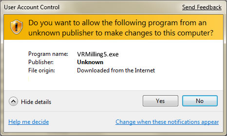

As of 6th May 2011, we decided to make our applications UAC setting to HighestAvailable.
This means that if you are an Administrator then you will be prompted every time the software starts, this is so that setting files which affect all users can be changed:

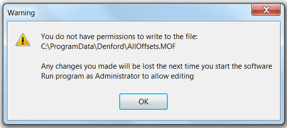

If you are standard user account then the software will run normally, but certain features will be limited.
for example you will not be able to edit/save tooloffsets:
So, for the example of the tool offsets file (AllOffsets.MOF):
Normal account:
VR Milling 5 will allow students to change the values but not save them.
QuickCAM Pro will be able to read the tool offsets file but not allow any changes to it.
Admin account:
UAC warning appears
VR Milling 5 will allow editing of tool offsets to be saved
QuickCAM Pro will allow editing of tool offsets to be saved
