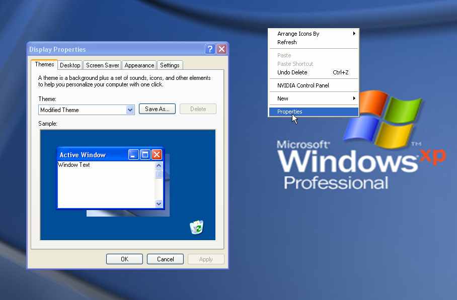

Step 1 Right click on your desktop and select properties.

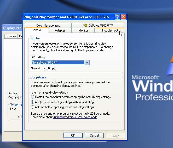

Step 2 Select the settings tab then click the advanced option at the botom right of the window

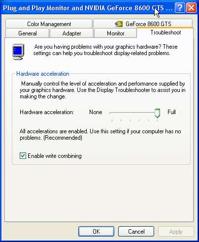

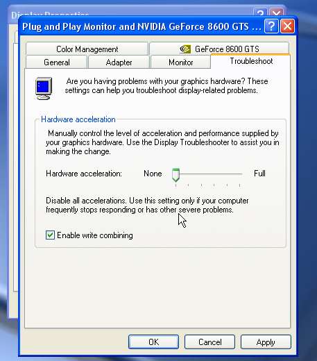

Step 3 Now select the troubleshooting tab and then drag the Graphics hardware acceleration slider to None
Step 4 Now apply the settings and see if the aplication runs.
Step 5 If this cures the problem you may repeat step 1 - 3 but dont take the slider all the way to the bottom. At each step on the slider different amounts af accelleration can be selected. Find the best setting that works and save this.

- full hardware acceleration.jpg (32.86 KiB) Viewed 18776 times
- no acceleration.jpg (38.88 KiB) Viewed 18776 times

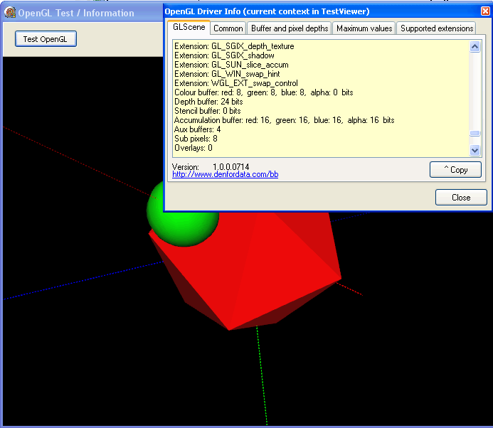

Here is a little OpenGL test and information application.
Just unzip it anywhere and run the .exe file
